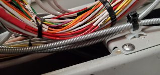

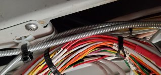

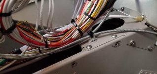

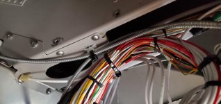

We had this happen and it was the EFIS fuse wire inside the cabin tunnel that attaches to the EFIS fuse. It was chaffing on the metal coil sheath cable for the co-pilot cabin heat control. The wires in the tunnel are tie-wrapped to the metal sheath coil and the EFIS wire from the fuse to the split to both G3X's is the one wire that was chaffing. I fixed the wire then put some rubber hose around the metal coil to prevent any other wires from chaffing.
