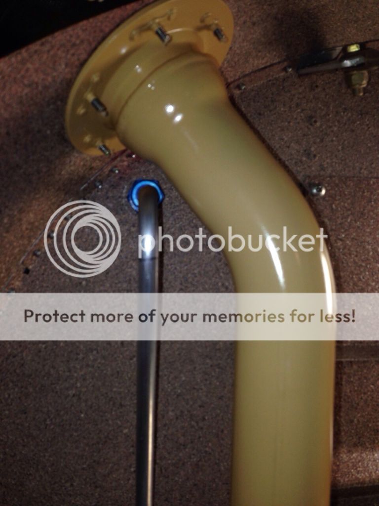

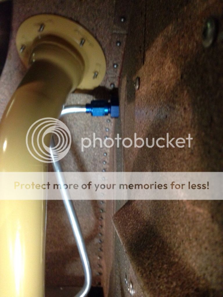

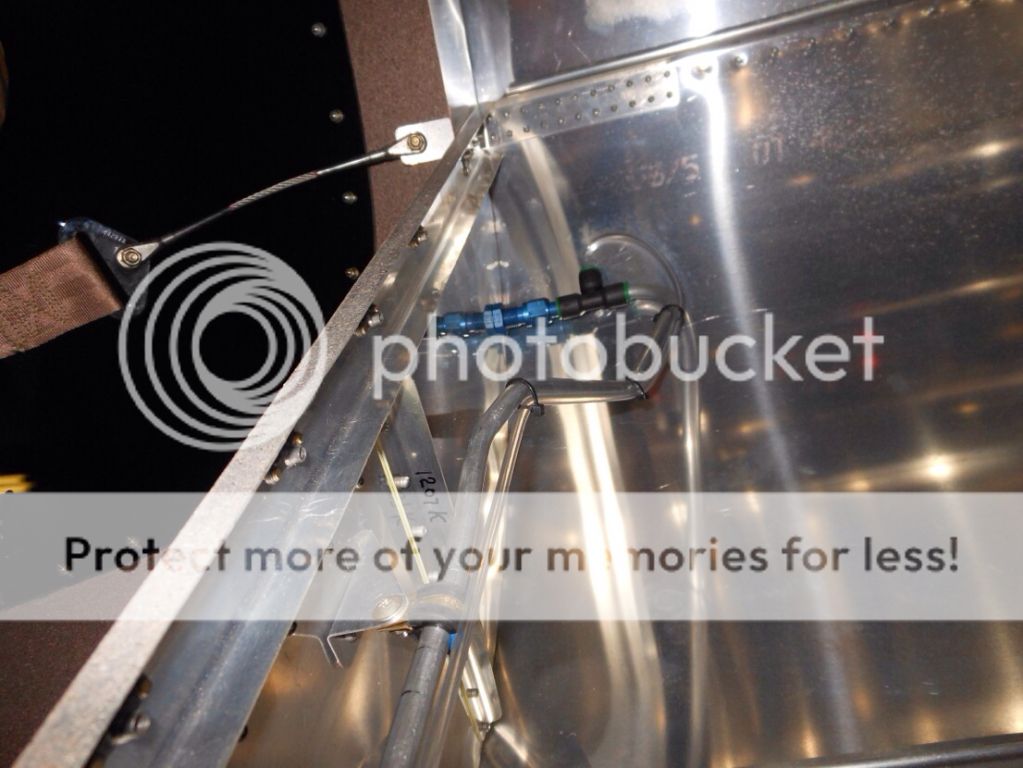

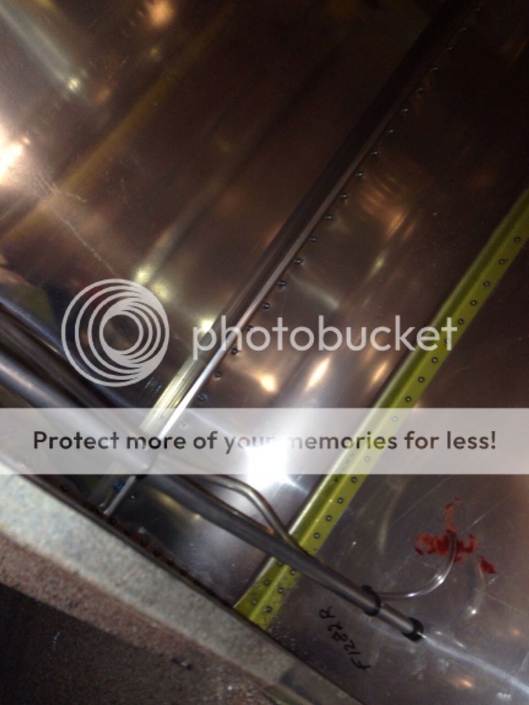

Fuel tanks vent mod pics.
Here is a few pics of the fuel tank vent installed. One change is installed a AN fitting in the aft bulkhead because of the rear interior vinyl piece. With this setup you just disconnect the tubing to remove the vinyl as discussed in another thread. :D

What AN fittings did you use to get through the rear bulkhead. I couldn't find a straight-thru bukhead fitting for the 3/8" connectors.
Through Bulkhead fitting parts numbers.
Part number for the through bulkhead fitting is AN832-6D and the nuts to hold it in place are AN924-6D.;)
