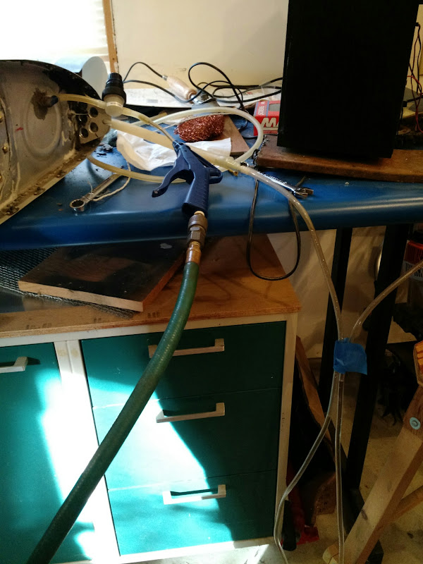

Whoa - 10' of water head is a lot, around 5 psi! I suspect joints that wouldn't ever leak in service might eventually leak at that pressure. I'd limit is to perhaps 1' - 2' of head. Best is to use air, limited by a very fine pressure regulator (not the normal compressor types...), and a blow off column of water about 1-2' high, and use soapy water to look for bubbles.
Sorry for the crummy picture, but here you can see I've got a very low pressure regulator, and the outlet goes to a loop of tubing. I've put water in the tube, and pressurize until I get about 12-18" differential. Just to the right of the picture the tube is open, so if the tank were inadvertently over pressurized, it would just blow the water and vent air. There is about 2" differential when this pic was taken.

Actually, the head pressure was much less than 5 PSI, as it was restricted to 1/4 ID tubing at the source. PSI means square inch. 1/4 inch ID tubing is much less area than a square inch, and in any case, the pressure wasn't high enough to bust the balloon that was also included in the test rig.
Also the tank most certainly would have, and in fact did leak as the entire rib to bottom skin fillet of sealant was not there, due to failure from the applier and inspector.(as stated in my post)
I would also disagree that it's "much better to use air", as that test was first performed with the air method and failed to display any leaks. This water test was done because one of my RV8 QB tanks also leaked due to a similar QB defect. I learned back then to test with a liquid or your wasting your time. Using Avgas could be better as it has a lower viscosity and could possibly find a leak that is too small for water, but using highly flammable liquid is far too dangerous in my opinion, unless you have a test rig that can control vapors, static electricity, potential spills, etc. I didn't and I feel that the water works fine. One note is that the water will not damage the tank, but you must purge for a couple of days with a very low pressure/volume of air after the test. Hook an air source to one of the inboard fittings and leave the gas cap off, then let it run. Another note: The fuel sender will read a direct short when submerged in water (avgas isn't a conductor),so don't plan on calibrating your gauges during this process, at least past the first few gallons until the water is high enough the reach the rheostat portion of the sender. (the bottom of the range is what the senders are really about anyway) Until the sender is submerged, you can accurately measure the reserve quantity if you make sure the tank is in the right attitude. Measure the resistance thru thru the sender to ground with an Ohmmeter and then simulate that resistance with a large (0-50 Ohm) rheostat when calibrating the EFIS. Be sure and remove the sender after you get the readings, and replace it with a cover plate as the water will cause the sender to rust and fail during the couple of days of testing. I just used the sender that I had previously ruined as a cover, before I discovered this fact!

I am really not interested in a debate of applications of laws of Hydraulics or Hydro-static pressure, I'm just trying to pass along some ideas of how I have successfully tested wing tanks for leaks, without damaging them. Again I would reiterate that the air method will not show you a leak of anything but air! The tank must be tested with a liquid for the small seepers to present themselves. Take six pounds of water in a gallon can, raise it the height of your light stand and attach a piece of tubing to the bottom of the can, and see if you can inflate a balloon with it. If it doesn't blow up in your face, then you can probably attach it to your tank and achieve a modest amount of pressure to test the tank.(actually 2 PSI) How do I know this? Because I have done it many times. (Spoiler alert, nothing blew). Use your still intact balloon as a relief valve. Believe the actual results, not miss-informed opinions and guesses.
