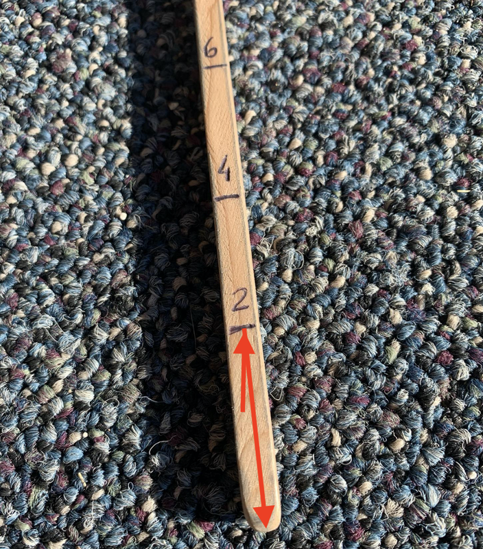

There have been some questions regarding my RV 12 fuel tank dip stick
Here goes. I made it from 1/4? square stick a spruce rib material from my current Pober Jr. ace project. I rounded one end. The stick bends slightly when inserted and it will travel all the way to the bottom of the tank. When I calculated the fuel tank sender I made a mark at each 2 gallon increment. I used a black ball point pen. Recently I installed a new CIES sender so I had the side of the tank open and I took the photo below. Using the dip stick you can also very accurately adjust the RED cube fuel flow.
