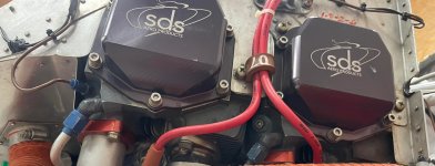

In the process of exchanging my engine, this what it looked like... the right side nipple being closer to the firewall where my e-valve is located, the routing is short and direct. The left side (excuse the truncated picture) a bit more meandering, held by small size Adels.
