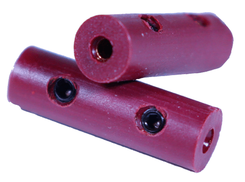

I also have the AFS system, minus the Avidyne and had the same experience with my Red Cube. I relocated mine to the engine mount, to eliminate the engine vibrations. I even bought a new Red Cube. Still intermittent. Also had intermittent CHT and EGT anomalies. I bought a package of EI wire connectors
https://iflyei.com/wp-content/uploads/OLC-2_web.png
I replaced every spade and butt splice on the sensors and Red Cube with these connectors and haven’t had any issues since. I’m a believer in these things.
