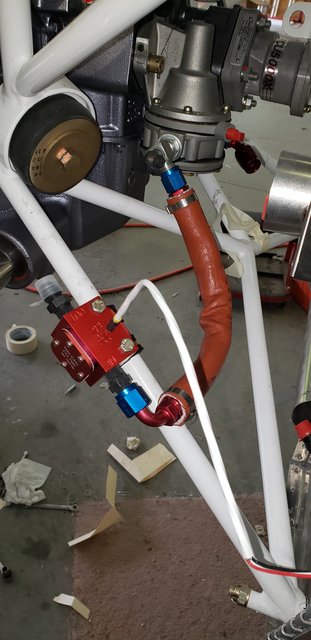

Background: RV-9A with IO-320 D1A. Fuel flow read from a Red Cube (new) driving an EMS part of an Advanced Flight 5400 EFIS. Red Cube mounted on firewall next to a Weldon 8163A boost pump. Engine driven pump is a Tempest, and was replaced about 70 hours ago.
Issue: When the engine is hot, I often get low fuel pressure when running on the engine-driven fuel pump while taxiing or on approach with manifold pressure at about 15 inches. No stuttering or anything from the engine, just low fuel pressure at the very bottom of the green arc according to the EFIS fuel pressure gauge. Doesn't do this during flight, nor when the engine is not heat-soaked. Works fine in cold weather and first flight of the day.
Trying to decide if this is a problem. The engine performs well otherwise. When I first picked up the plane, the engine-driven fuel pump went out...noted when the engine kept dying while taxiing. Replaced the original Lycoming engine-driven pump with a Tempest at that time. That was about 70 tach hours ago.
Any thoughts...?

Mac, Although it could be a marginal mechanical pump, IMO it is just heating of the fuel as you mention, some vaporization causing the lower pressure on the business side of the pump.
I noticed some actual FF and pressure wandering at cruise and installed 5 thermocouples from the fuel entry into the cabin to pump inlet. It increased much more than I had expected. Sorry don't remember the numbers, but your exposed pump FWF will certainly add to the temperature rise.
Is it a "problem" ?? . . . . if the standard boost pump procedures don't completely address it, yes. Otherwise just follow the procedure. Insulation of the pump head, cube, and tubing will certainly help lower the threshold for the pressure drop occurrence. You can get sheets of insulation at a Speed shop and make covers with RTV seams pretty easily. If you wanted to experiment, or more margin.

Thanks guys. I am inclined to suspect that fuel is boiling, but I've yet to see any actual functional problem with fuel flow or pressure (other than hard starts when hot). I'm just a little gun-shy since I did have the engine-driven fuel pump go TU on my first flight while ferrying it here from St. Louis. I am going to figure out an insulation scheme and give that a try.
Two ways to do it, stand off heat shield on the exhaust and insulation wrap on the pump and lines. I do both whenever I have exhaust near fuel lines. You can get the stand off shields from ACS and one brand is anti splat. Theirs works well.
Mac,
I suggest you have some basic issues that need to be fixed before you go chasing possible fuel line heat causing your pressure drop.
Looking at the photo, I note that you have the fuel line going into the (new) red cube, then into your electric boost pump, then I assume to your mechanical fuel pump. I also note a bunch of 90 degree fittings.
I refer you to the EMS install instructions on placement of the red cube (as in between the engine driven fuel pump and the engine and not mounted on the engine) and fuel line considerations on the input and output of the cube.

Per the instructions that came the red cubes (I have 2 one for the return to tank) “the wires exiting the cube body must point up !” Yours is 90* off going directly through the firewall and the little counting wheel is laying flat instead of being vertical.
I’am suspecting what’s happening is with the boost pump off the cube is in a vacuum situation as the mechanical pump is drawing fuel through the pump, when everything including the fuel gets hot forward of the firewall some fuel vapors form and hang out in the top of the wheel chamber of the cube and fail to make the counter wheel spin consistently and the incorrect orientation compounds the problem. When the boost pump is turned on the red cube’s situation changes to being a pressurized condition and fuel flow can exert enough pressure to make the counter wheel spin appropriately.

Thanks Carl. I’ll have to look at it again (I didn’t build it) but my recollection is that fuel goes from the
engine-driven fuel pump —> boost pump —> red cube —> engine. My understanding is that the firewall-forward was done by Don Swords at Don’s Dream Machines.

Fuel line routing and configuration, and especially boost pump location, might be an issue, but it would be a PITA to re-configure and although I appreciate the input, I’m gonna put those fairly far down the list of things to try.
As an AP I would like to chime in here.
First of all I see a HUGE fire risk with the piece of soft aluminium tubing between the pump and the Red Cube. It is simply not good practice and should be taken out before further flight.
Then like others have mentioned.
1) Get rid of those 90 degree fittings. You just have to.
2) Make sure you use proper fuel lines and fire sleeve them.
3) I would install the electric boost pump and the red cube behind the firewall.
4) Install the Red Cube with the leads pointing up.
5) Make sure that there is a restrictor installed between the fitting on the engine pump and the line running to your FP sensor.

One good example of the configuration is: Fuel selector - fuel filter - Boost pump - Red cube - engine pump - FI body - spider. there are also others.
From the FT-60 (Red Cube) install manual:
Mechanical Interface:
If the aircraft has a fuel pump(s), the flow transducer MUST be installed downstream of the last fuel pump.
Installing the transducer upstream of the fuel pump(s) can cause vapor lock and jumpy/inaccurate readings.
The Red Cube FT-60 has 1/4" NPT ports. Apply thread sealant to fittings, assemble and torque fittings to
8-10 ft. Lbs., DO NOT EXCEED a torque of 12 ft. Lbs. The Red Cube FT-60 should NOT be installed with the wires pointing DOWN (the best situation is with wires pointing UP). Also, the fuel line on the outlet port should not drop down after exiting the transducer. Both of these configurations can trap bubbles in the transducer causing jumpy readings. The inlet port, outlet port and flow direction are marked on the top of the Red Cube FT-60.

Now look at the RV-14 FWF instructions that put the cube between the fuel pump and the Fuel Manager on the engine. Good placement except the instructions have you hard mount the cube to the engine in a high heat area (goes against the guidelines). Here too I have first hand knowledge of the fuel flow going to ~11GPH when above 7K’, regardless of mixture setting. Moving the cube to a proper location solved the problem. Note - other RV-14 builders have not reported this problem but I have second hand information that the same issue presented itself on an RV-12.
We changed out the red cube, no joy. Engaging the appropriate vendors yielded no technical feedback. We can only postulate that the combination of vibration, heat, atmospheric pressure along with inlet and outlet hose lengths set up some kind of resonance that the little spinning wheel did not like.
We do know that meeting the guidelines eliminated the problem - so that is how I install the flow meter.

Carl, I pulled the cowl a couple of days ago to review the fuel line routing. I found that you are correct...the fuel line goes firewall -> Red Cube -> boost pump -> engine-driven pump -> fuel servo -> engine. Fuel pressure readings come from a T-fitting off the engine-driven pump and routed to the fuel pressure sensor. This was apparently the routing chosen by the guy (Don Swords) who did the firewall-forward work for the original builder 11 years ago. Performance on fuel flow readings isn't affected. I'm not sure if this arrangement causes or contributes to the hot-engine fuel pressure issues I'm seeing (gauge fluctuation and mildly hard hot-weather starting), but I think I'm going to start with insulating the exposed fuel lines and figure out a way to insulate the Red Cube. I appreciate your input.
