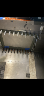

On a flying plane?A number of builders have installed an access panel on the ‘tunnel’, near the cabin floor.

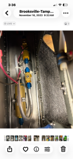

Usually it’s a 2 wrench process. One on the fitting being loosened and one onthe stationary part— another reason to use open end wrenches.On a flying plane?
I lack confidence in being able to do that at present.
I need some way to secure the filter while I ratchet
Yeah, I think I need to put mine back in that hose clamp and hold it tight. It should work just got really frustrated today. I took it out of the hose clamp thinking I could spin it freeMine has the filter body secured with a hose clamp which helps hold it steady while the fittings are loosened / tightened.
I took an box end wrench that fit the hex on the filter, cut an opening large enough to fit over the line, and then had a home built line wrench to hold the flats on the filter.
Use a wrench. Even channel locks will work.On a flying plane?

It is definitely doable on a flying plane. I installed the access panels on a 10 while under construction. Much easier then. It makes access to the filter/pump easier but still awkward. And yes, stubby wrenches are a requirement...skinny arms and small hands helps too!On a flying plane?
I'll argue that stubby wrenches are a nice to have, not a need to have, at least for working in the tunnel. I'm about a month away from embarking on my RV-10's 12th condition inspection and I don't own a single stubby wrench. Can't argue about the skinny arms and small hands though.And yes, stubby wrenches are a requirement...skinny arms and small hands helps too!
I bought the access panel kit but have not gotten around to installing it ... too many projects...It is definitely doable on a flying plane. I installed the access panels on a 10 while under construction. Much easier then. It makes access to the filter/pump easier but still awkward. And yes, stubby wrenches are a requirement...skinny arms and small hands helps too!
This is a neat solution, and doubles as a gascolator if needed.
Aerolab Flush Mounted Filter Gascolator
Flyboy Accessories is proud to be the exclusive distributor for the Aerolab Filter Gascolator. This new, top-quality, flush-mounted filter assembly, made by Aerolab in Italy, has been designed to be installed inside the fuselage, flush mounted in the belly skin. It can also be flush mounted in...flyboyaccessories.com
Oh dear, that's sad.They have been discontinued. Was a great product. I have two of them.
Same one outboard under each seat.They have been discontinued. It is a great product. I have two of them.
The builder of my RV10 installed an access plate ( maybe 5"x 8") on the bottom of the fuselage directly under the fuel filter. There is a very robust doubler were the access panel is with nutplates and screws every inch or so. I would post a pic but not back home for a few days. Even with the access panel its a little time consuming but probably much easier than going in through the tunnel. Having the plane on an Aero Lift does make it easier to do some of the inspection.I bought the access panel kit but have not gotten around to installing it ... too many projects...
Yep, this is the way. Learned this from Pete Howell.I took an box end wrench that fit the hex on the filter, cut an opening large enough to fit over the line, and then had a home built line wrench to hold the flats on the filter.
