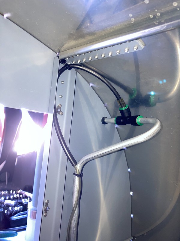

Can someone explain how the fuel vent airline is supposed to prevent siphoning of fuel.
I filled the airplane for a long flight yesterday. The fuel level was mid way in the neck. During the day the fuel expanded and started the overflow, apparently it became a siphon with the overflow line. This morning it took 2 gallons to top off the tank.
I thought the air vent line was supposed to eliminate this.

I realize the volume increase will start the overflow draining the excess gasoline.
It should stop when the excess is removed, instead once it starts flowing it will remove all the gas above the fitting in the tank because it becomes a siphon. As I understand it the air vent should break the siphon so only the excess (volume increase) is removed.
Check the fitting
I had a similar experience.
Check that the anti-siphon line is not blocked, kinked or crimped.
Also. peek behind the bulkhead to be sure that the T-fitting is still upright. Mine had rotated to the side and downward which allowed fuel to enter when overfilled and fuel warmed up.
Good luck!
And one more thing...
I determined where the high point of the vent should be so that the flexible tube is relaxed and unlikely to kink, then I fabricated a small clip to support the tube so it couldn’t flop over again. One rivet thru the clip and fuselage skin did the trick.
Thanks Dave and Scott,
You nailed it. The air vent line had become disconnected from the "T" and the "T" was turned down. There was evidence fuel had been on the inside skin coming from the "T" . I believe that has been my gas smell when the canopy is slightly open, I'll know for sure after a few flights.
I added 6" of line and raised the loop well above the "T" intersection and zip tied it in place. I tested by overfilling the tank into the neck, the overflow drained out the bottom and stopped when the level was 2" below the cap.
