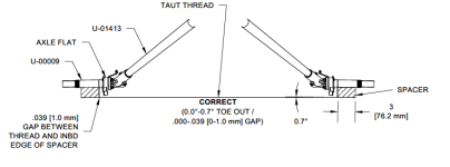

For the tailwheel guys, main gear toe-in or toe-out?
moespeeds
Friend
I measured my gear, and I'm toe-out 1/4* each side. Grove gear and axles.
In racing cars, toe-out adds instability, and a tendency follow any turning inputs. It makes a car that will want to pitch into the corners, but can be darty on straights.
Toe-in will give you a car that rolls straight, and resists turning inputs.
I would describe my 8 as darty on rollout.
So I can adjust my toe in 1/4* increments using shims from grove. Should I go zero toe, or toe-in? What's everyone else doing?

This is a subject that predates the oldest RV by decades. The flat spring gear was designed and patented by Steve Wittman in 1936. The round gear in early 50's.
Camber with zero toe in three point attitude becomes toe out as the tail is raised. Very undesirable.
Put enough weight in the plane to simulate typical flying conditions.
Get some greased plates and put the tires on them so they can find their happy place.
Adjust the toe to zero with the tail down.
Ignore speculation about what happens when the tail raises... it won't matter enough to worry about.
YMMV!

As has been said, "0" toe is best. Toe-out is better than toe-in. Think of it this way, if the airplane starts to veer to the left, more weight is transferred to the right wheel. If it is toed-in, that wheel will take you even more to the left. If it is toed-out, it will tend to pull the airplane back to the right. ref: "Landing Gear Design for Light Aircraft" by Ladislao Pazmany.
If you will notice Van recommends "0" toe with the airplane off the ground. With the Wittman style landing gear, by design, any weight on the gear causes a small amount of toe-out.
When I designed the conventional gear for the Moni Motor-glider back in the 1980s, I discovered quickly that any amount of toe-in makes the airplane quite squirrelly on the ground. Once I added a minute amount of toe-out, the airplane became a pussy- cat.

You are entirely correct that in racing cars, toe out is desirable to make the turn in more aggressive. The reason for this is that at turn initiation, there is little weight transfer until the entire chassis rotates to give the rear tires the angle of attack (known as "slip angle" in tires), they need to create a lateral force. Toe out makes the inside front grab more aggressively on turn entry, speeding up the rotation of the chassis. However, the opposite is true with a taildragger aircraft: Mainwheel toe OUT creates a stabilizing force.
First, let me explain my background to give a bit more credibility: I am a Mechanical Engineer, with 35 years' experience in engineering and driving of open wheel (Formula 2000 and others) cars, reasonably successfully. Chassis setup was my specialty. Now, why toe out?
As we all know, the tailwheel aircraft is inherently unstable on the ground because the CG is aft of the main wheels. If both wheels have toe in, both wheels will be creating a force towards the centerline of the aircraft when rolling straight ahead. When the aircraft diverges from a straight path (swerves), even slightly, weight is transferred from the inside wheel to the outside wheel, thus the outside wheel will have a greater lateral thrust capability and the inside wheel will have less lateral thrust capability - the net is an increase in force in the direction of the swerve, increasing the swerve rate, and requiring a very authoritative rudder response from the pilot.
Conversely, if the wheels have toe out, both wheels will be creating a force outward, away from the centerline of the aircraft when rolling straight ahead. When the aircraft diverges from a straight path (swerves), weight is transferred from the inside wheel to the outside wheel. Again, the inside wheel loses some lateral force, while the outside gains some lateral force. But here's the key: weight and lateral force capability is still transferred, but the toe out of the outside wheel helps to "steer" the airplane straight.
Note that the airplane is still unstable, but less so with toe out. In my own case, my RV8 had an initial toe IN of 1.25 degrees. I found the airplane to be controllable, but "nervous." Using the VAN's supplied shims, I set toe OUT 0.25 degrees. The "nervous" feeling was greatly reduced.
Now, look at the same analysis for a tricycle aircraft: Toe IN is stabilizing as the CG is ahead of the main landing gear. Think about it…..
As noted above, when transitioning from tail up to tail down on landing, the camber of the wheels will move the wheels towards toe in. For the typical10 degree nose up three-point attitude this will translate to approximately (10/90 x camber angle) or .11 degrees per degree of caster. This argues for even MORE toe out to retain relative stability in the 3-point attitude. At my next condition inspection, I'll increase the toe out to see if this can be documented.
As an aside, by changing the toe in I increased my tire life from 240 landings to 600 landings, and the wear is much more even (both sets of tires were Goodyear Flight Eagle III)

See my post #8 above. Slight toe-out is better and is specified in the plans. Plans call for 0 toe with the weight off the gear. The RV gear toes out when weight is applied, by design.

Just went though this with my -6, which I built with (it turns out) 2.76 deg of toe out (weight off wheels, level attitude). This is an early kit without pre-drilled holes. Always had serious inside tire wear, but ground handling was fine. Also measured toe with weight on wheels in level attitude (4.6 deg toe out) and tail low (2.41 toe out). So, the gear definitely goes more toe out with weight on wheels in level attitude, like you'd get with a wheel landing.
By oblonging the gear rod retention bolt holes in the engine mount by ~.020", I was able to get to zero toe (level attitude, weight off wheels), which is Van's factory spec. Landing characteristics are unchanged, but it definitely rolls better now.

Another datapoint. My Rv8 was toe-in 0.13 deg weight off the wheels (as per Vans) measured wheel to wheel. It landed on the mains straight and tracked straight until the tail started coming down around then got wiggly. I put a grove shim marked 1/4 deg ( it actually measured closer to 0.2 deg) which resulted in a toe-out of 0.08 deg. I estimate the uncertainty in these measurements is +/- 0.04 degrees BTW.
I them lowered the wheels down onto a soap lubricated concrete floor in 3-point and pushed the plane back and forward. I remeasured the toe and found it to be toe-in 0.08 deg. Both wheels had a positive camber of 1.0 degree.
Landing before after in similar conditions qualitatively felt better. Semi quantitatively, I noted the lateral acceleration in the 1 second data from my EFIS on roll out. Toe-out reduced the lateral acceleration by roughly 50 percent.

As weight is applied in a 3-pt attitude, the gear toes in so this statement doesn't make sense. I've measured toe with weight off and on multiple RVs and Rockets using grease plates and bags of salt to simulate pilot weight and verified this to be the case. And as the drawing Vince posted toe-OUT is shown to have a stabilizing effect, in a crosswind. So not hand waving 👋👋👋👋:)

There is something else that happens, the toe and camber changes as the tail comes up. On an airplane with round gear. This is not the case on the RV-8 with flat gear.
Having taught tailwheel a time or two, what always gets a budding tailwheel pilot in trouble in a crosswind is not enough rudder to track straight so the airplane weathervanes. The outside wheel gets loaded further, which TOES-IN further, due to the weight increase on the downwind, outside wheel. That wheel will skip, and the gear will fail due to excessive side-loading, depending on the airplane (have watched it happen in real-time twice).
Bottom line: set toe to be neutral in a typical flight weight, in three point attitude, and always land in a three point attitude.
