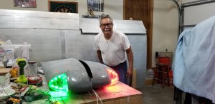

Yes! Since Sept 2020 LOVE them. #Xbright I built them myself, very easy and fun. Extremely bright, taxi or taxi/landing light. When Landing or Taxi lights or on and Strobes are off, the Strobes light up at 30% for extra light and side lighting to see the edge of the taxiway. Getting ready to pull the trigger on a 14 build and I will use them again. #FlyLED
