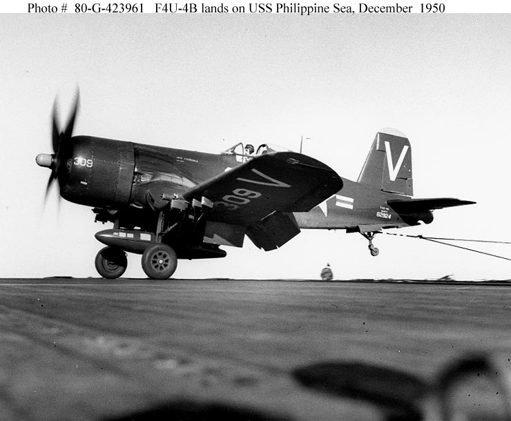

As you would expect, any canopy with sloping sides or back of any consequence is going to act as a drag, if not an outright parachute. Most already have detached airflow over the top, so slide it back and youre gonna get more of the same, but even more aft. Probably not what you want. Note the WWII fighters and such that had sliding canopies - straight sides and top. Ever seen a P-51 with the bubble canopy open in flight.....?
Open bubbles
This bubble canopy was opened in flight -
And even the late model, full bubble Spitfires...
I think it depended more on other factors than "straight sides and top"...
