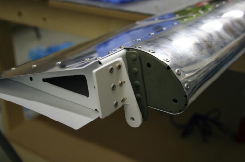

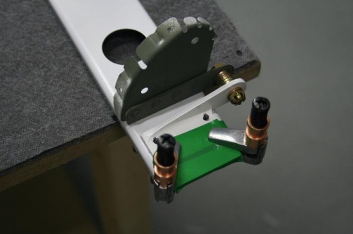

A couple of questions again for the guys who have completed their wings. On page 18-04, it calls for 8 AN960-10 washers between the actuation arms to set their separation distance. This produces a gap between them of 1/2 inch. Before I drill the A-1207-L bracket, is this spacing correct, since the bearing on the W-1212 hinge bracket is only a little over .250" thick? Also, which rivets did you use on the A-1206 pivot brackets- I don't see the rivets in the callout. Thanks Steve
