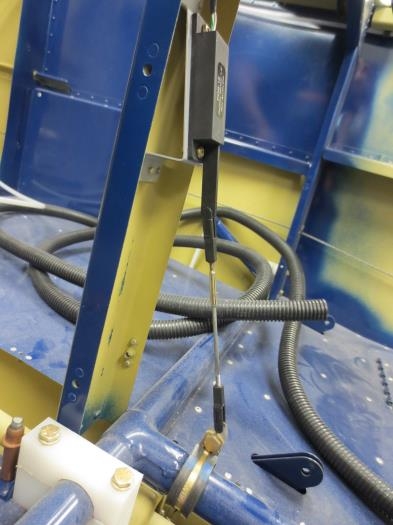

Has anyone used a Ray Allen position indicator sensor to indicate flap position? I've got a flap positioning system from Showplaces installed but I want to add a position indicator to the panel. I think the Ray Allen POS-12 sensor plus the trim indicator lights (I didn't use it on my elevator trim set up because it feeds into the EFIS trim position display) should work. Has anyone fitted a RAC POS-12 sensor and if so do they have a photo of the installation? Alternative suggestions welcome. Thanks.

I ended up just making a 30 deg bracket as the rotation does not have significant non-linearity from stop to stop.
Here is the connection to the tube. It had to be modified to allow a radius adjustment (shortened over the top of the weld) to keep travel from exceeding the sensor limits. This was GEN I.
Dont use the full travel of the sensor!

Dont use the first and last 10% of the travel only use the middle 70-80%!
Check with an ohm-meter, how the resistor value is changing. You will see, that at the ends, the value does not change anymore.
So if you are using 100% of travel, then you will have in the beginning and in the end of the travel a "dead zone" where the value does not change, but the flap is moving furter.

I hope your wrong, only because I just took my fuse off the rotisary and on to the gear last night, uggg, so are you confirming this with a 5 V supply, and just wondering if the Dynon calibration setup will work this out? I think I went to 3-5 % play at the end of travel.......

The big reason I did not use the full travel was hitting the stops and damaging the sensor, it is not untypical of electronics to adjust to the "stopped" condition - even it it did not hit the mechanical end.
Since you asked for alternatives, I'll give you my 2 cents. I too installed the Ray-Allen (MAC?) back in 1998-99. Much as shown above with a lightweight custom bracket. Originally, I had the LED display on the side panel (-8). But since transitioning to the D100/120, I never use it. Removed the LED displays as well. Flap pos is not in any of my Dynon screen rotations currently. Aileron and elevator are.

I installed mine as I had seen done on this forum. The last 10% of travel each way is not used.
