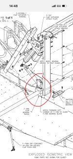

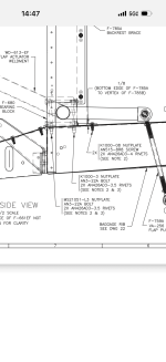

Building a 7A. I drilled the F680 bearing block to the center bulkhead and baggage rib. The instructions say to install nut plates for the bearing block bolts. The aft one on the baggage rib is no problem. However, the forward is a problem. No matter which way I turn it, it can’t be installed without drilling a hole through either the edge of the baggage rib flange or bulkhead flange. Is there any reason I can’t just use standard nuts here?
