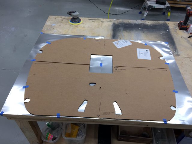

I did mine in SS foil over FibreFrax. A cardboard template fitted in place made the conceptualizing and cutting jobs much easier.

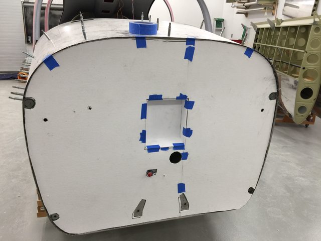

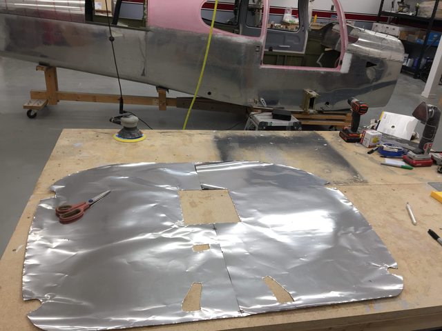

This is how mine came out.
Cardboard template traced and cut. Laid atop the FibRefrax and then the SS foil sheet for marking and cutting. Where possible, I made the flaps that fold into the firewall recess of one piece with the larger sheet, the remainder are overlapped and covered with the aluminum foil tape. SS pop rivets and washers from McMaster provide the attachment in the middle and Fire Barrier caulk to seal and affix the edges.
For reference, I only added stainless to the lower center firewall. Effectively a 24x24" piece of stainless over fiberfrax that covered the area over the tunnel and the likely exit path for any under-cowl fire. Then, I used another 24"x24" piece on the belly with fiberfrax underneath.
I rationalized that the rest of the firewall was unlikely to see the same temperatures as the lower center firewall. I pray that I never have an opportunity to test my assumption.
