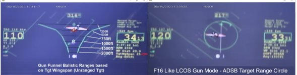

I also have a good bit of AF fighter time followed by 15 years of my retirement helping develop the F35 weapons and avionics systems that included several thousand hours of test time in Lockheed's F35 CATB flying F35 avionics test lab and Lockheed's Fort Worth F35 test labs and simulators. Getting to help birth a 5th Gen Fighter Plane was a Dream (& Nightmare) come true. What I got out of all of this was a burning desire to build and fly my own RV8, and I wanted it to be more than just an awesome airplane, I wanted it to have some of the fighter plane like systems that modern fighter aircraft also have. So my RV8 mini-fighter plane checklist is as follows;
1) I wanted a great honest smooth flying well coordinated tandem seated aircraft with a great fighter like view and roll back canopy. As most fighter pilots would agree you and your airplane need to become 1, so that you know your aircrafts flight envelope with confidence and can use that envelope to the fullest when needed. Choosing the RV8 to build and fly was actually never in question to fill the first part of my checklist. Its not like any fighter plane or jet I've ever flown, but its a great aircraft and the fighter plane part has been left up to me to fill in.
2) My F4 flying taught me that an Aural and Visual AOA system will without a doubt help teach me what that flight envelope is, give me subtle clues when I'm flying inside my flight envelope, and aggressively alert me when I'm flying along the edges of my flight envelope. For that reason I became a founding member of the FlyOnSpeed AOA team and have one of our Gen2 AOA systems in my RV8. Having a real AOA system definitely gives a fighter plane aspect to my RV8 experience. Yes fly by wire fighter planes don't have and use AOA like the F4 did, but AOA is still a critical part of the aircraft flight computer and avionics and the AOA information is shown and used at times by the pilot.
3) All fighter planes also have a HUD of some sort, so my son and I set out along with several other folks to build a modern type HUD that I was motivated to integrate and install into my RV8. With all my years in the F35 avionics world to say I was spoiled is an understatement. But to complete the RV8 transition to a little Fighter Plane my first thought was a HMD (Helmet Mounted Display), but it was quickly obvious that was a bit to far, so we started by developing our own basic HUD software that is driven real time using the aircraft flight and NAV data available from modern experimental avionics such as Garmin, Dynon, MGL, etc. Using established fighter HUD graphics designs like from the F16, F18, and other systems we designed our own HUD graphics and experimented first with the HUDLY, a Car HUD, then I moved to the Epic Optix aircraft quality HUD. To complete a RV8 Fighter HUD you need to include Gunsight modes in the HUD, so the software includes both a fixed (un-ranged) Gun Funnel mode that has wingspan modes for 25ft, 30ft, and 35ft, and a F16 LCOS mode using differential ADSB ranging and displayed on target range circle . The computer finds the nearest ADSB target from ownship and provides a range circle from 9k feet to 100 feet. All Tgt info is also digitally displayed such as N-number, range, etc. All HUD modes are selectable using a small 10 key keypad. The EPIC OPTIX HUD will not fit on many of the Vans Aircraft that don't even have a dashboard. So we have also developed an AR (Augmented Reality) version of the HUD, right now the AR Glasses have a fixed forward view only HUD display but we are working hard to develop a Head Tracking version (say F35 HMD like - but some $399,400.00 cheaper).
To sum this all up. My RV8 and the awesome world experimental aircraft aviation has created has provided me all the RV8 fighter plane I imagined it could be. Hopefully the pictures and video below will give you an idea as to how this all works. You can also hear the OnSpeeed system "Fast" tone come on several times toward the end of the video. Due to aircraft vibration affecting the HUD camera the video is less than perfect but the cockpit HUD view is smooth, and my RV8 is in a turn that flys through the morning sun several times but the HUD never becomes unreadable or washed out.
More Info is available at FlyOnSpeed.org/hud and Tronview.org
See my "RV8" Gun Camera Demo Video at--> https://www.youtube.com/watch?v=0BEmGv72IiI
View attachment 110289View attachment 110290
This is pretty amazing work, I can only imagine where this tech will go, probably in the direction of wearable glasses of some kind- similar to the stuff you worked on for the F35. I fly with the HUD on the 737 and would love to have a HUD on the RV8, but that is about 15 projects down the list!
As the tech has advanced- have you given any more thought to a wearable (helmet type) device?
Tron, I LOVE your RV-8 HUD!!! Especially the funnel and LCOS "gun" sight. I'm hoping you have a recording system included so you can go back and prove to your buddy that you got RATRs/BATRs on him or her.
I get why you need that extension of the mount into the cockpit from the edge of the glare shield, presumably to get the right focal length to project the HUD symbology. But do you find it gets in your way at all?
Have you thought about having it project upward from inside the panel onto the HUD collimating glass?
Final and most important question is: How do I get one of these??
Thanks for the compliment, the HUD I use is from Epic Optix and the design is fixed, the extension from the panel has a special mirror on the backside of the controls which is needed to reflect the HUD LED projector image onto the combining glass focused at infinity. As I have come to fully appreciate building a HUD that really works in full daylight, in Color, good resolution, and that cost less than the RV8 is not easy , Epic Optix sells this one for $1500 dollars. My son and I write the software that integrates with the avionics and drives the HUD graphics. Send me a PM and I’ll explain more of the details.
