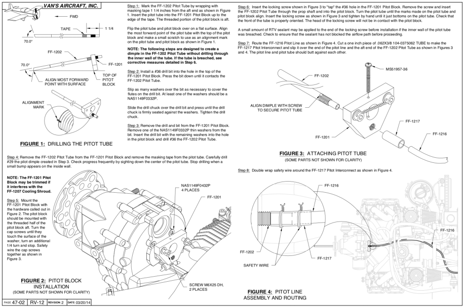

My FF 1201 (plastic block holding pitot tube in place mounted on the back of the gearbox)) was full of cracks that look to be simple deterioration from 10 years and 1000 hours of use.
It would not hold the pitot tube in place any more. I just machined a new one from aluminum instead of plastic . I used the old one for a pattern and made it exactly the same.
I think this would only apply to the older higher time RV 12s
