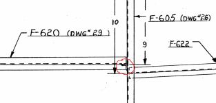

F620 aft end , cannot see how it attaches to f605..
On my build instruction paragraph 6 from the top of page it is mentioned but no way to attach to f615.
Ho do I proceed.
Prints pg 32 middle page bottom and bubble area directly above…
What am I missing.
Billy the kid
I attached it with a piece of angle 3/4 x 3/4 x .063 and three rivets through the arm rest and three rivets through F605.
Looks like a 3/4" angle goes there to tie together. You can just make it out in the drawing. I'd use 1/16" wall angle.
