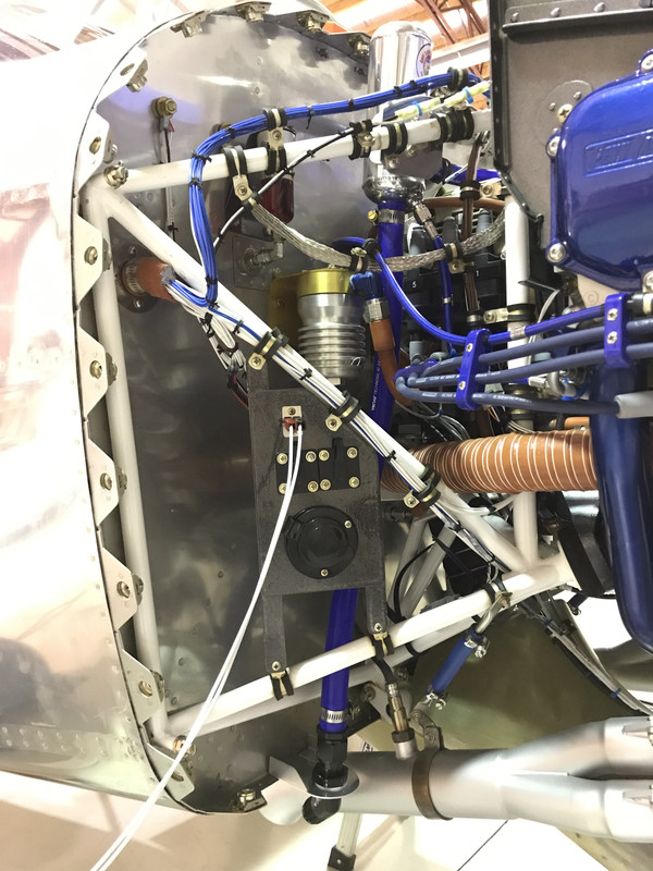

We built a small panel mounted on the engine mount and accessed through a door in the cowling.
Both of our ETX-900’s are mounted forward of the sub panel, so close by. The panel has ports for the two batteries (Optimate charger as recommended by other posters), a 30 amp Anderson power pole connector (for powering up avionics, etc. using a regulated power supply) and a 110 VAC connector to power the Tanis engine pre-heater.
We are also electrically dependent and my intention is to never jump start the plane, hence the Anderson versus a Piper or Cessna style external power port.

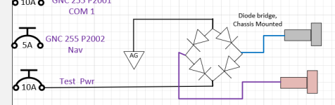

I have a circuit breaker on the panel labeled "Test Power". it is wired to a diode bridge and a set of banana jacks on the sub panel. When I want to power up the panel, for say software updates, I pull the test circuit breaker, plug in an external power supply to the banana jacks, set the voltage on the external supply, leave the master switch off, and then push in the test circuit breaker, and the panel comes alive. The only issue is the voltage on the external power supply needs to be 2 volts above the desired panel voltage due to the drop in the diode bridge. The diode bridge allows me to plug the banana jacks in any which way, and the polarity of the power to the panel is always correct. I am thinking of switching out the diode bridge with a relay bridge instead, thou.
simple but useful
