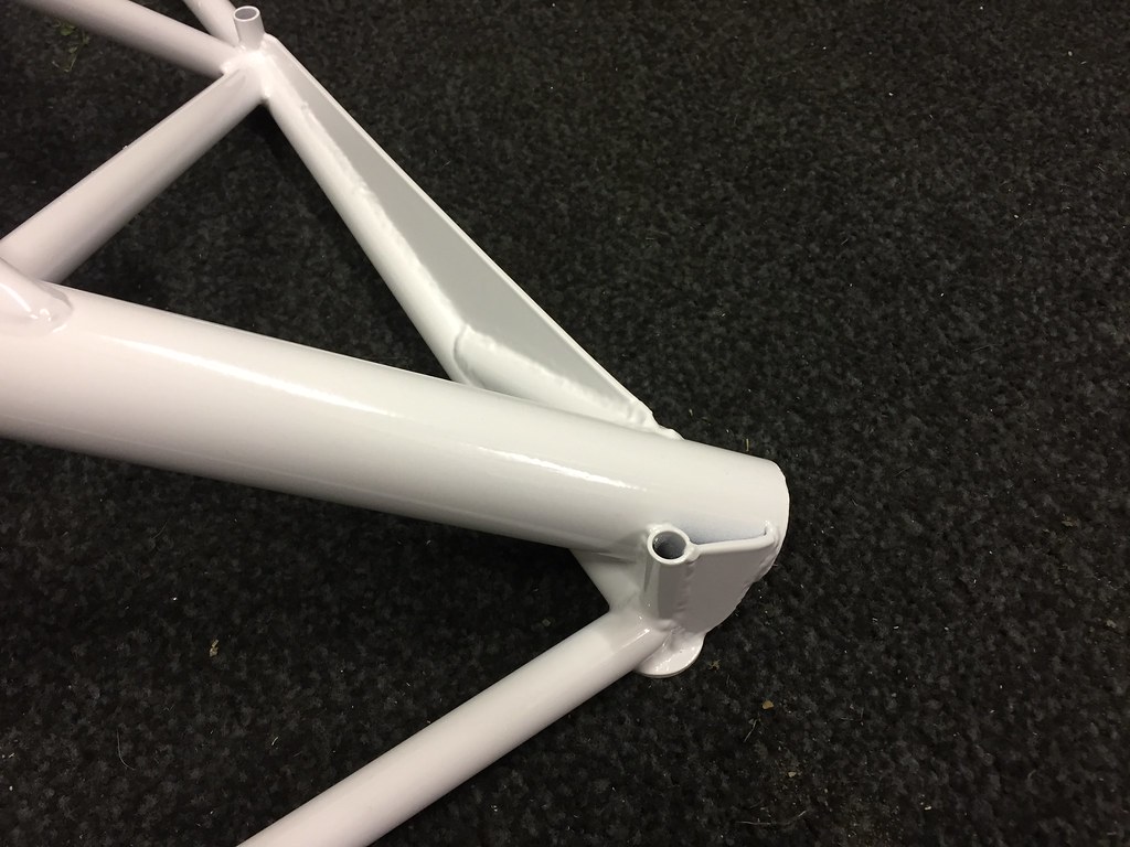

Engine Mount cracked
Pittsartist
"Every picture tells a story" or so the saying goes.
........... So here's my little story.
Spotted at the 2nd annual from new, 116 hours total logged, Almost all flying off grass strips (in reasonable condition)
Cracks in gear leg sockets - both sides, same place, red Dye Pen shows it
[/url]IMG_3387 by WIGY TV, on Flickr[/IMG]
Mount off
[/url]IMG_3372 by WIGY TV, on Flickr[/IMG]
http://flic.kr/p/Rse2Pw
S9Tza7
Engine Off
[/url]IMG_3380 by WIGY TV, on Flickr[/IMG]
Strip Mount
[/url]IMG_3391 by WIGY TV, on Flickr[/IMG]
Bare Metal ready for Welding
[/url]IMG_3393 by WIGY TV, on Flickr[/IMG]
3 Days work so far. I'm expecting the get the mount back later this week and start re assembly - Predicting about 6 days work in total to repair the problem.
What I have learned so far
- The standard "6" mount is in need of some strengthening if you regularly operate from Grass
- I plan to change my operational technique post repair to give the mount as easy a time as possible (No more "Wheeler" ladings, Tail up taxiing, choosing rough grass strips when a smoother alternative is available, 20 min Aeros flights that could be tagged onto the end of another mission)
- There seems to be 3 levels of repair available
1) Just weld the cracks
2) Weld and add reinforcement gussets from 4130 steel
3) The above plus replace the gear socket tubes with custom made replacements machined from steel billet with a thicker wall.
- Above all, I really wish I had done "2" in the above During the build
I don't suppose there are that many 6's at this stage of build these days - but I hope this post may be of use to any that are.
...... Still love the aeroplane though, No regrets :D

I'm just home after finishing my repair.
I've spent 24 of the last 48 hours working on it. It was welded for me Friday, Painted friday night and then all day Saturday and Sunday to re assemble and test run.
I'd say It's taken about 50 hours work to do the whole thing including welding (2), Stripping and Painting (10) and putting it all back together again (24). I did manage to get a few other jobs done at the same time though - oil change, air filter clean, secure spat mounting brackets, replace a fuel hose.
Ready to test fly if the weather is any good in the morning. I'll post some photos as soon as I get chance.
Beer time !
Hard to tell from that pic.
Remove the powder coat with paint remover to bare metal and inspect further. If your mount does not have the gussets, ie later style 7 mount, it is probably a matter of when, not if.
I'd found that Dye penetrant testing on mine was really the only way to be absolutely certain. The kit cost ?36 .... no doubt I'll be using it again in the future some time.
All finished and test flown, so far so good.
As mentioned before, I'd estimate about 50 hours work all told - although this did include a few small "incidental" jobs as well.
The only real snag worth mentioning was that when removing the mount a center bolt went back into a metal fuel line behind just the firewall. This in turn resulted in a fuel leak on the outlet of the Andair pump which is just in front of the main spar. I was very lucky to get away with this - It started up and ran fine for 7 mins during initial warm up but then started miss firing during my "1 min at max power" final ground run before flying. The pipe had fully fractured on the flare so a 3/8" pipe @ 30 psi leak !
Here's some photos.
(Edited 5th April 2017 - It turns out that the end plates I have fitted in the photos below are not to the approved UK Mod spec, my mistake but please don't copy them !.)
[url=https://flic.kr/p/SmRjfQ]IMG_3431 by WIGY TV, on Flickr[/URL]
[/url]IMG_3430 by WIGY TV, on Flickr[/IMG]
[/url]IMG_3429 by WIGY TV, on Flickr[/IMG]
[/url]IMG_3433 by WIGY TV, on Flickr[/IMG]

Nice pictures...thanks for sharing.
Nice Job welding gussets.
But just to be clear that is not the WD-762A-L and WD-762A-R Gear Socket Gussets Vans sells for the Dynafocal mounts.
Is that a homebrew or did Vans direct it for a Conical mount?
You did not show a picture of the bottom view of the small triangle at the tube where the Vans gussets fit.
Again, nice work!
Hi Bob,
The gussets are from drawings often referred to as the "Netherthorpe mod" here in England. It's an LAA "Repeat mod" first done on G-ODEE in 2004. It seems almost every UK aircraft I look at has had this done
They are basically home made from 1/8" 4130 Steel plate, 4 parts are added - the elongated triangles (welded top & bottom) and the roughly 2 x 2" end plates welded to the mount ends.
Cheers,
Richard
Cowl
Have you put the cowl on yet? From the picture it looks as if there is an area that is going to be close to the cowl at the landing gear.
Richard,
Thanks for the reply.
1/8 is thicker than the Van's gussets.
12 years of history says something!
All good info. Best pictures I have seen posted regarding the fix.

I had serious cracks in my -6 mount. I welded the cracks after removing the mount, and welded a heavy ring around the bottom of the gear leg and over the cracks after smoothing the weld beads over. Rather than adding gussets I made multiple passes from the bottom of the bolt tubes to the heavy ring. I believe what I came up with is stronger than gussets.

That is amazing! I am glad I have the gussets as I have made more than a few landings that should have broken something, although I think most cracks in engine mounts are fatigue.
I fancy myself as a decent welder. Then I watch Russ, and realize I am a hack. He is the best and you will get a fine product back.

We were doing the annual on Louise's RV-6 this past week, and sure enough - the cracks have appeared. It's remarkable, actually, that it took over 3500 hours and 30 years for us to see the problem (although there are some reports it might have happened before - but I don't see a previous repair on this mount...), especially since this is kit #4, and there are no gussets.
So the engine is coming off, and the mount will find its way to the Greater Portland area will Russ will work his welding magic, fix the problem, and add the gussets. And meanwhile, we'll do some FWF clean-up. This has been (and will continue to be) a strong, working airplane!
