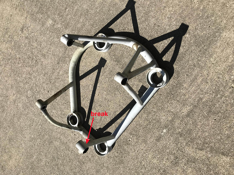

I’m just starting Annual Condition Inspection at 633TT and began by looking at engine mount standoff for cracks per SB-00023. Standoff looks good; however, further inspection of the main engine mount found a cracked tube at the lower left engine bolt. Two tubes are welded in a cluster at this location and upper tube is severed in half – lower tube looks fine. I suspect the failure is induced stress from welding. Perhaps the normalizing process wasn’t sufficient to equalize strain in the two tubes that form this joint.

I have located a welding shop that specializes in TIG. We will make a jig to hold 189mm vertical spacing between mounting pads per Rotax Engine Installation Manual. Crack will be chamfered with a carbide burr for good weld penetration. Tubing will be preheated to around 800F, TIG welded, and cooled slowly. A Chromoly 4130 split over-sleave will be welded in place to complete the repair. Lucky thing (if you want to call it that) the crack is in the straight upper tube and not the curved lower tube. I will find somebody locally to strip and powder-coat.

Now that the mount is no longer bolted to the engine the crack has closed up and vertical spacing between mounting pads is less than 189mm. When we jig the mount for 189MM vertical spacing between mounting pads the crack will separate just like when it was bolted to the engine. So, when welded, the mounting pads will line up with the engine bolt holes.

Weld repair is complete. Chromoly 4130 split over-sleave is TIG welded into tubing cluster.
Third photo shows weld fixture to hold 189mm vertical centerline distance for engine mounting pads.
On closer inspection… on the left side of the mount (broken side) I see heavy internal thread markings in both the top and bottom engine mounting pads. See photos below. I think this engine mount was made incorrectly from the get-go. My guess is the 189mm vertical centerline distance was compromised during initial fabrication, and when assembled to the engine, it caused tension and stress in the lower tube.
Engine mounting pads on the right side of mount look pristine. Now that mounting pad centerline dimension is corrected with this repair, everything should be hunky-dory.

I have added a third photo to my post #1 above. I am in contact a RV-12 builder/owner in Australia. He has now discovered a second crack in the main circular back mounting ring after disassembling cabin heater control cable. He is in process of installing new engine mount after discovering crack on lower right side near oil tank. I would think main circular back mounting ring is very robust and that cracks would appear in thin tubing where engine attaches, like in my instance.
