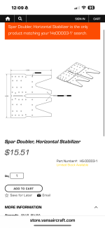

If it was mine I’d replace that. It’s a doubler from a SB. Pretty cheap part to replace. $15.00View attachment 93586

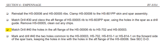

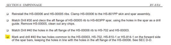

Drilled this as best I could with a 12 inch bit from HS-810-1 through HS-702 out to HS-00003-1 where I wound up with this bad edge hole. Any chance this could be fixed? Is it worth emailing Vans?
Thanks for the reply! The problem is the doubler is match drilled so the next hole will wind up in the same spot on HS-00003-1. It seems like I'll need to replace the spar, the splice angle, the rib and the doubler. Unless I can drill a hole somewhere else on the doubler but there's not a lot of space.If it was mine I’d replace that. It’s a doubler from a SB. Pretty cheap part to replace. $15.00
Related to this - I reckon a lot of 7/8 HS spars have marginal edge distance on the top and bottom spar web to doubler holes ( the one you have circled in blue in the original photo )View attachment 93586
