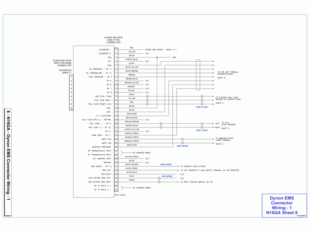

Your example of adding a piece of equipment after the fact can easily be done by simply creating another sheet. Our interconnects seem to be getting easier as time goes on and more and more equipment is connected by serial digital buses. It may be that the new equipment just needs a new bus connection and audio in and out lines to the existing equipment.

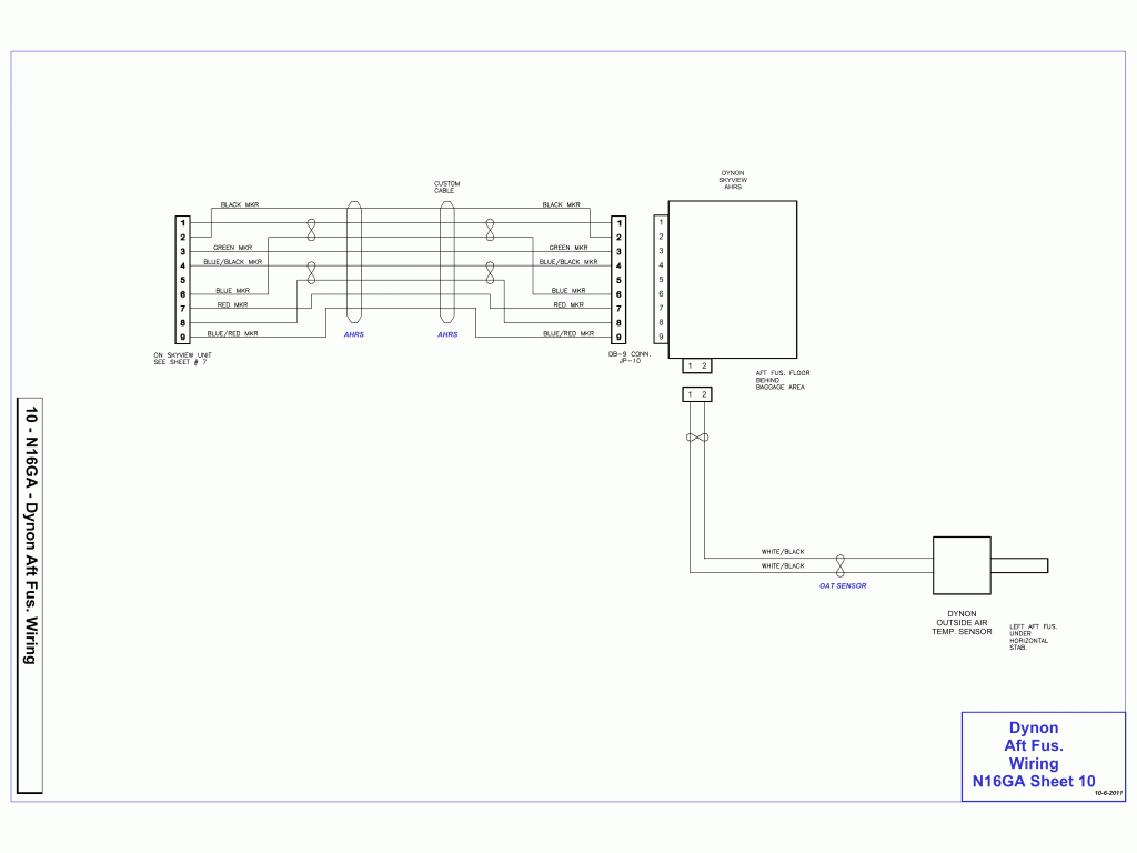

You do end up with sheets with little on them, but it may be considered an advantage if you separate the sheets by physical location. This is my aft fuselage sheet -
It is 11 x 17 (before I saved it as a 4000 pixel gif) with 0.2 line spacing, but should be legible for editing and a quick view on letter size.

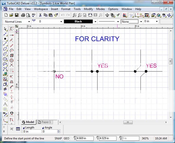

As far a CAD generated "bridge jumps", I'm confused, the industrial/commercial standards for them went away decades ago. A line crossing another line is just that, a line connection has a dot to show joining, and a crossing with a dot should not exist since dots can get lost in printing. Hence this standard I mentioned -

Even the EMS wire schematic sheet was easy to make with your colored wires. The connections tend to form into bundles going to their own sheets. Once a sheet is made, not much automated moving of blocks is usually required -
