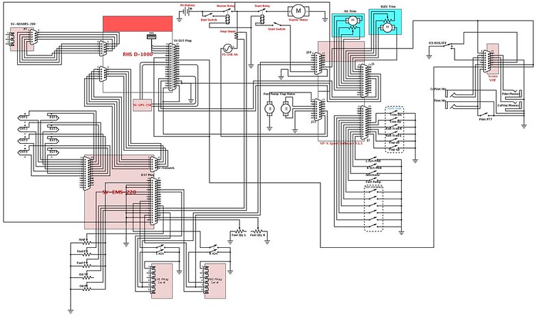

Here's a complete example, along with source:
Vern, I was just looking at your thread from a few years back this morning and checked out two or three of your PDFs. They look pretty good to me! How do you feel about component theft from your source file? :)
Go ahead, pay it forward.
V
