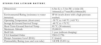

Kathy from Earth X informed me recently they will be updating their Earth X batteries for our experimental aircraft with the same specs that govern their TSO line: (New temperature guidelines) Seems I've been pushing the upper limits on my FWF battery mounted low for years. :oops: They also use the same BMS.
