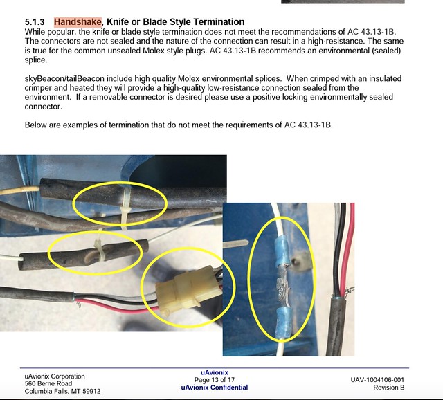

Every one of those stye connections I've ever seen on an airplane (even with the clear tubing over them) has had corrosion.
In fact, where a good quality low-resistance connection is critical, this style connector is specifically called out as unnaceptable by at least one avionics manufacturer.
If you have to use something other than sealed environmental splices (in the tail expecially), either use Dsub connectors fastened together with 4/40 screws and nuts and wrapped in silicone self-fusing tape, or get some Deutsch IP67 rated connectors with the barrel-crimp style pins. You'll have to buy the crimp tool. And, you'll have to strip the wire long and double it over to take up enough space in the pin to get a solid crimp.
I use Raychem environmental splices in areas that may be subject to water intrusion (like the vertical fin and rudder fairings).
99% of the fleet just got grounded. Blade style connectors, fuse blocks, sub D’s, even shrink wrapped pins don’t meet that interpretation.
