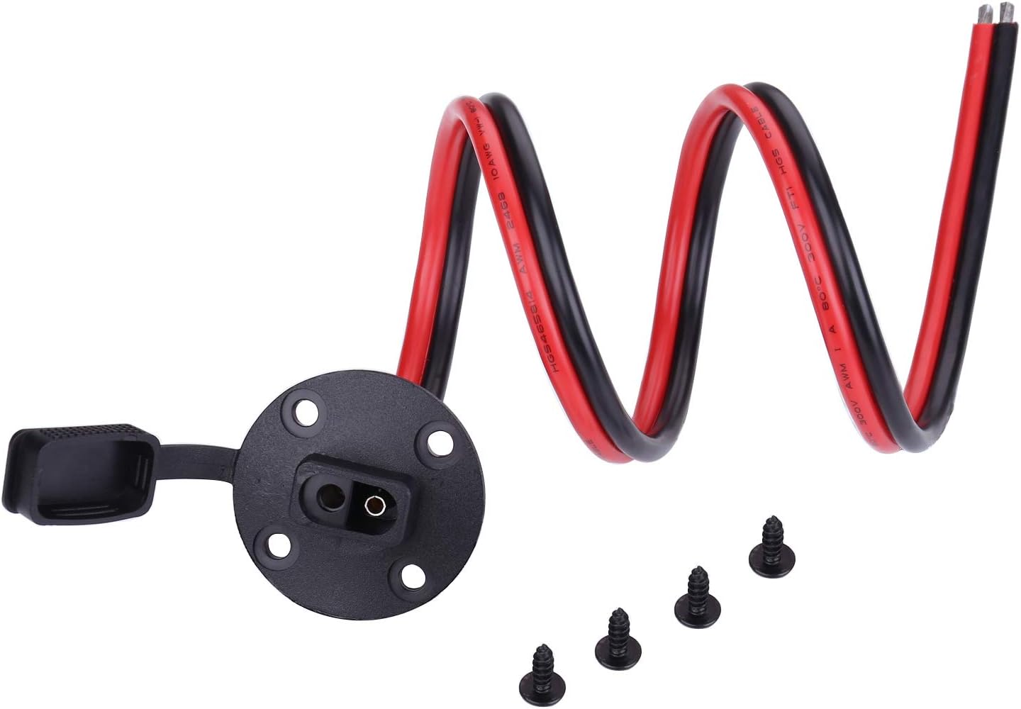

I use the common SAE outdoor rated plugs with 10ga wire. The SAE plugs are the common two-pin configuration that most chargers use. The recommended EarthX Optimate chargers use these SAE plugs. I bought the more expensive Optimate TM 275 from EarthX that can be used as APU ground power as well as a charger. The 10 gauge wires on the SAE port are plenty big for that. I install these in the belly of the aircraft for exterior access and install the included weather boot when not in use.
https://www.amazon.com/dp/B07SL3MBR6/ref=dp_cerb_2

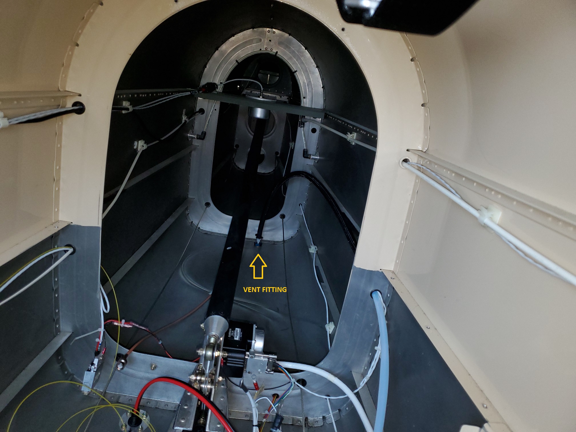

You can see the one in my RV-8 in the lower part of this interior photo (red and black wire):
I have these in my RV-3B (interior), RV-8 and Aviat Husky (both exterior belly). I installed one in another friend's RV-8 on the inside of the forward baggage compartment through the firewall. His battery is located on the firewall and he can plug in the his charger inside the baggage hold.

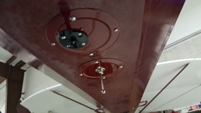

Here is one on my Husky (along with my ADS-B in antenna):
