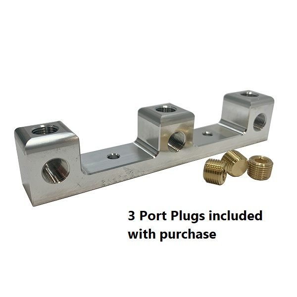

Hi All----we heard a rumor that Dynon was transitioning to a Threaded MAP sensor, vs the old block style 'automotive' unit. I found this pic, but not being an avionics guy, I thought I'd ask. If this is true, then it would simplify some installs for us, especially where PMAGS and similar ignitions are used. 2nd pic is a 'concept' we've been playing with for mounting the legacy MAP sensor near the sender manifold, to make our installs cleaner.

Hi Chip---Thats the info I was looking for. since the new MAP sender can be threaded into the 3rd port on the Va168, it matches our Garmin kit. This is going to simplify alot of things!!

Unless you couldn't find the MAP sensor for Dynon, according to the plans, so you cut the third port off, as a weight saving option, according to the plans.
Since I cut the third port off and VA-168 is not available (backorder). What options do you have available Tom? I was planning to get the lines from you for my dual Pmags... maybe you can help with a good mounting method for the new MAP?

I used this https://showplanes.com/Item/TC-12MAP

Chad,
Check Stein. I looked a few days ago for a friend, and it showed he had one or more.
