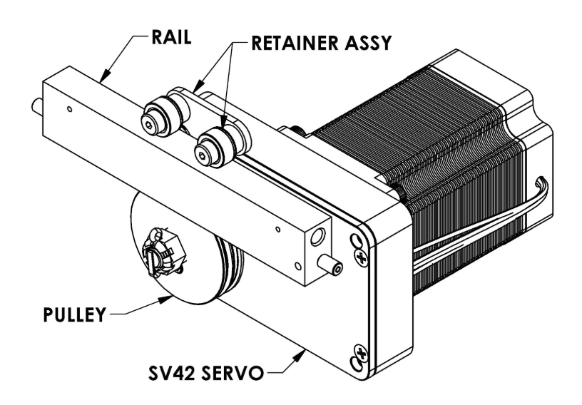

Applicability and Affected Equipment
This bulletin affects the pulley on the Dynon linear actuator, which may be found on:
Some Dynon Avionics SV42T Autopilot Servos (P/N 101008-003 / 101058-003)
Some SV32 and SV42 servos retrofitted with the Dynon linear actuator
Fig 1: Dynon SV42T servo with linear actuator
Unaffected Equipment
The following equipment is NOT affected by this service bulletin
SV32, SV32L, SV32C
SV42, SV42L, SV42EL, SV42C
SV52, SV52L, SV52C
Additionally, Dynon Certified installations are unaffected by this service bulletin.
