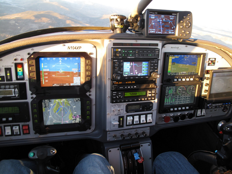

I am wanting to install a flip up video player in my panel. Does anyone know of a problem with interference or heat problems if it was installed in the radio stack?

Back when I was building, I had the idea of installing a flip-up DVD player in the right side of my panel but was warned by members of this board not to. The reason being that a car DVD player would impart noise into the audio circuit.
I never did install one and we just use my laptop or iPod.

I have a DVD player, it's just not the flip up style, in my panel. Works great with no interference. I have it running through my panel mounted intercom so it mutes with radio traffic and the audio fades back in.

I have really enjoyed our DVD. I have screens in the back seats that work very well in the sun. The DVD on the panel is not quite as good but I would do it again. As for interference, when I turn the DVD on it actually removes some interference that appears to be caused by the Grand Rapids. The only noise I have right now in my system appears to come from the alternator and I have talked to B&C last week and ordered some insulators for my headphone plugs. They think that should fix it.
I can control my iPhone/iPod with my DVD player. It is a touch screen that makes it easy to navigate the playlists.
During the day we typically will not watch a movie with all the great scenery.
Hope that helps.

Beautiful panel, Scott! You sure did a great job of fitting a lot of stuff into limited space.
