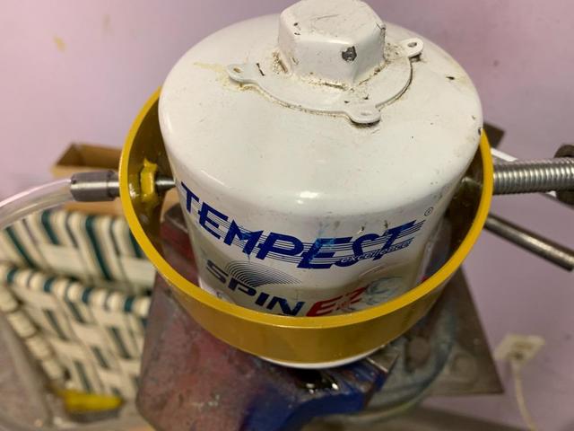

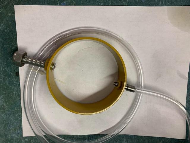

Here is a nice tool a friend made for his RV-14. Slip it over the end of the filter, tighten the bolt on top and let it drain via a hose on the bottom. Not a drop is spilled.
Enough people have asked for one that he is opening a production line.

I just bought some $0.75 small bread tins from walmart and hold them under the filter while I spin it off. So far the 5 times I've done it, I've spilled a few drops only once.

Avery had a tool like this.... punch a hole in the top install band with drain, turn the filter 180 degrees and let it drain.
