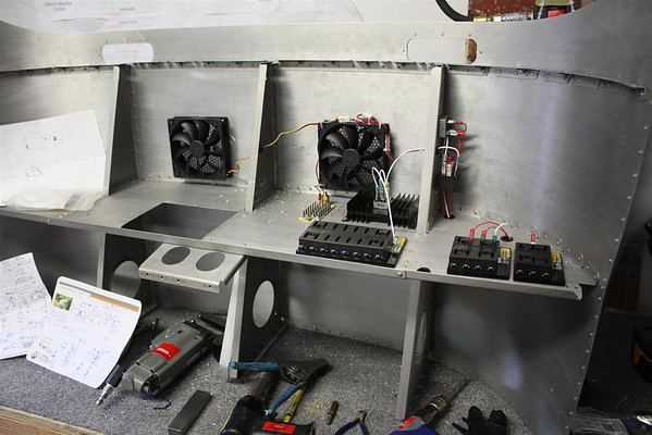

I've decided to install 2 120mm defrost fans in a spot very similar to Brian and Brandi's:
Do y'all suggest installing a doubler around these holes on the underside of the skin? An .032" doubler with a single row of rivets and corner holes for the #8 screws doesn't feel overkill, but a 1" thick doubler like Vans suggests for the radio stack hole DOES feel overkill.
What are other people installing here to support their fans?

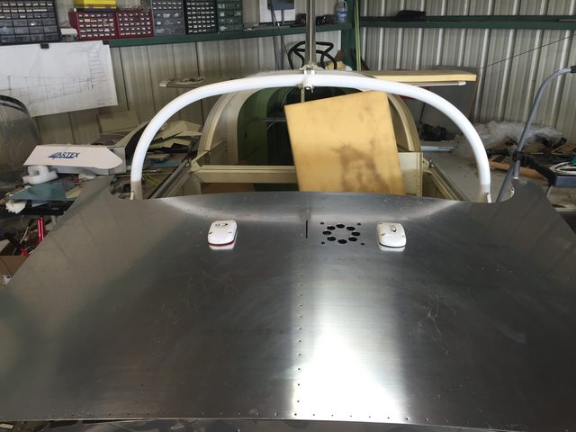

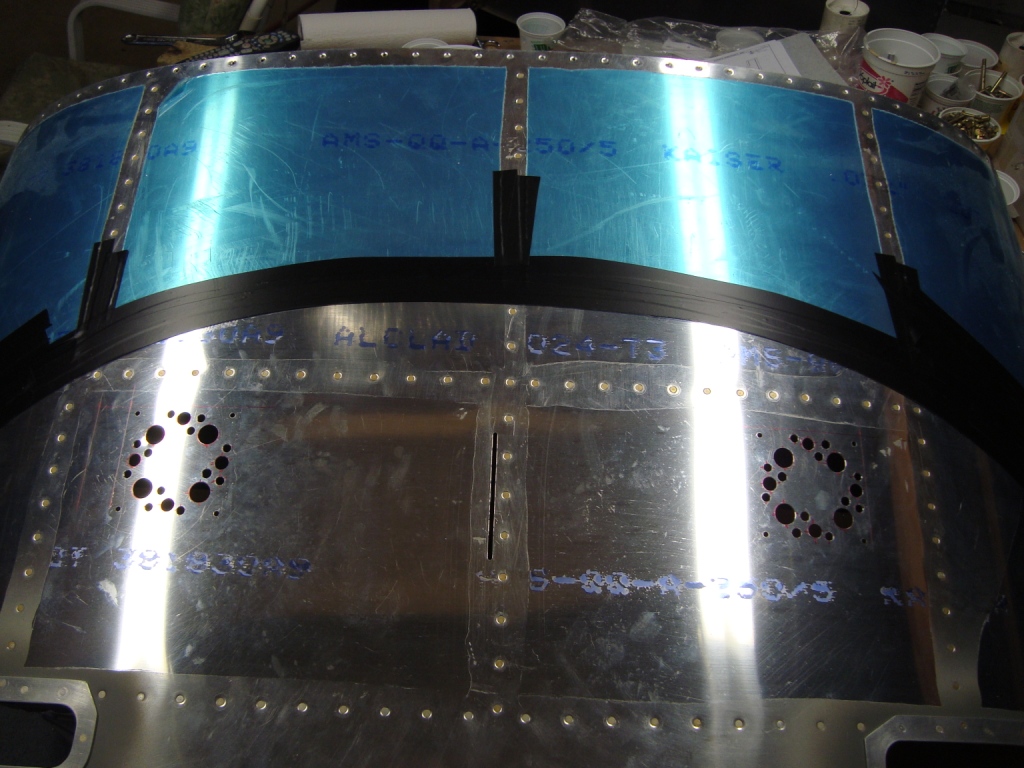

An option is to not use a grill at all, just drill an interesting pattern of holes in the glare shield instead of one big square hole. This strengthens the area so no backer plate is needed, and eliminates the ugly grill.

+1. This is what I did. No flex in the glare shield. (In the -10 this is best done prior to installing the windscreen, depending on the exact location of the fan).

+2. Drilled some holes for airflow.
