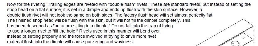

I've missed something somewhere, or maybe not.
We're all familiar with Section 5, but I'll repeat it here for clarity.

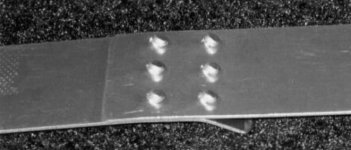

Question is, how big is an acorn? When I inspect, I see them in all sizes, quite a few being small enough to make me nervous. Here are some pretty ones, at least to my eye:
A little less wonderful, good enough for most, but...
And I've seen some small enough to pull through without much effort.
So, is there a published criteria specifically for the shop heads on trailing edge double flush rivets? I've been assuming it is the standard 1.5 x shank size minimum, so please correct me if wrong.

Hard to believe there is no aerospace standard specifically addressing double flush rivets. The failure mode I'm seeing in my mind's eye has the small shop head pulling through the bottom of the dimple, similar to the way the manufactured head pulls through a nested dimple.
Photo credits: Bill Marvel
A #40 hole expands to about 0.104" D when dimpled, so a 0.122 diameter shop head only has 0.009" of overlap at the edge of the hole, in the bottom of the dimple. And that's measuring at the largest diameter. Depending on the bulge of the shop head, the actual contact diameter may be as little 0.118
