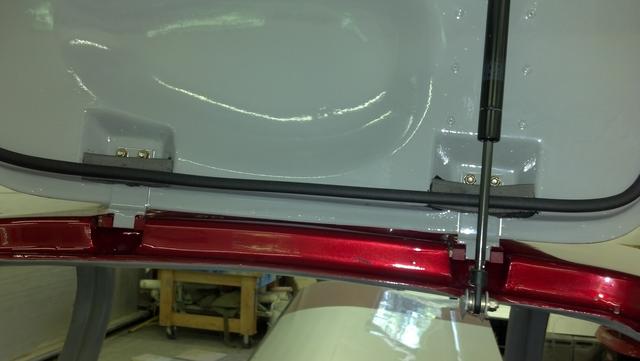

I'm at a frustrating point in my build. 13 months ago I spent a week molding a lip in place on the doors using the McMaster 1120A413 seal material as a female mold. Now a year later I'm sanding and filling doors for a final perfect fit flush to the cabin top and realize, Hey! - I should trial fit the seals before finalizing this little detail... :eek:
Somehow I seem to have slept through the threads (that I even posted in) about the proper set-up for using these seals instead of Van's: I have less than 1/8' clearance in some areas. Needless to say, my beautifully contoured doors won't come close to closing with the seals on. I've been grinding away at flox and pink prepreg for the last 3 days. :(
I think what Strasnuts meant to say is if you only have 1/4" of gap, you will need three linebackers pushing on the door to get it to close. I now have one door with .30" clearance all the way around and it still won't close with those 3/8" bulb seals on. Portions of the doorway are now so thin the seal won't stay on - almost knife edge. Time to add some flox on the inner doorway edge to build it back up. This will likely necessitate some spot repairs to the interior paint job.
I have decided not to sand the doorway any further into oblivion until I try the next (and only) smaller size seal McMaster seems to offer - a 9/32" diameter bulb on a 3/16" width C-channel. I'm hoping this will grip the sharp edge of the doorway better in more places, and that the 3/32" added clearance will let the door pins engage.
At this point I'm thankful that this screw-up, like virtually any with fiberglass, is fixable with sufficient time (or $$time$$ as Bob Nuckolls likes to say), effort and resin. The "elephant" just got a few dozen bites larger, but it's being eaten nonetheless.

I went with the 1140A4 series because 1. others had, successfully, and 2. I wanted something to dress the doorway edge with a nice wear-resistant wrap. I will consider a seal on the door face as a last resort.
Different door seals are $50 a pop from McMaster. Relatively cheap, but only relatively. 9/32" bulb already on order. I will report results.

My doors are things of beauty as far as fit, flush-ness and handle operation as long as there's no seal in place. I think this will just come down to a matter of making the gap such that the bulb is not fully compressed. No apparent reason that wouldn't be the case. I do have one door that's a tad stiffer than the other, but have not resorted to lubrication yet on either side. Trying to avoid surface contamination ahead of paint. The inside handles will close the doors with one finger; the outside factory handles require a whole-hand grip.
With .25" gap on one door and .30" on the other and a seal in place, there is no way to press the door down hard enough to make the thing sit flush even locally in the opening. The pins will not even start to engage. I doubt the issue is the PlaneAround latch, but I admit you might well know better. Just doesn't make sense yet to me it would be a latch issue.

I believe most of the "fight" from the seals comes from points closer to the hinge line. I'd start looking there. Have you put some play-dough or a similar material in the gutter, then closed the doors, to see what the real gaps are without the seals in place?
I suspect you are right about the upper portions of the door seal putting up more resistance. I haven't yet used modeling clay as a gauge, but have been progressively sanding and using a box end wrench of known thickness as a go/no-go gauge all the way around the door.
Pleased to report the smaller seal fixed the interference issue at the stage I was at, eliminating the need to grind more of the cabin top to powder. The 3/16" width is a good fit on the thin, almost knife edge areas of doorway I have created with all this relief sanding, and the 9/32" bulb makes a good seal all the way around with minimal resistance to closure. Two finger's pressure operates the door handles inside and out.
