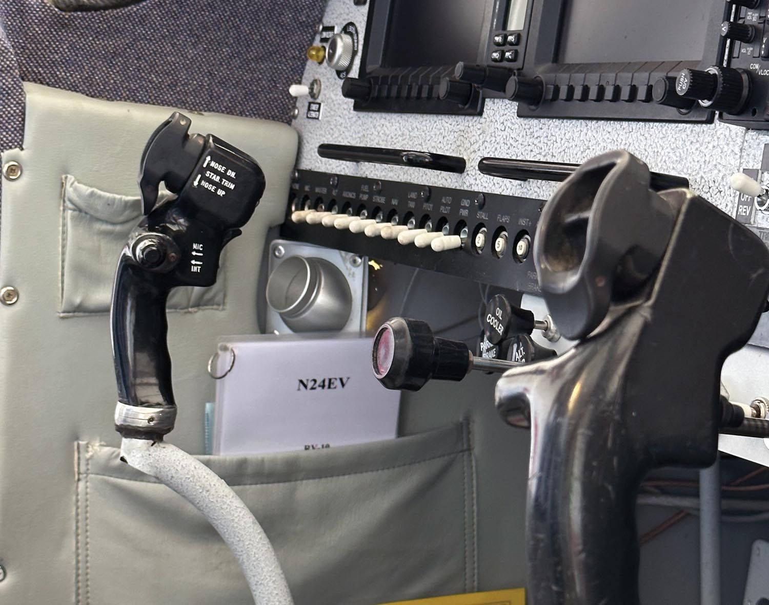

I made these stick tops and just used a foam grip below.
I tried to 3D print my own but failed.
So I used one from an old (really old -- 15DB connector) game joystick.
Note that it extends down around the actual control stick so if the plastic were to break you're still holding the control stick.
And for the simpler kind, carved this out of a limb cut off the apple tree in my yard. Only has a push to talk. The rear one came out better, that is what is pictured.
Having the rear stick in the the -8 means you can't do full inverted (stick hits the seat back) so it is usually out of the plane. That's why I have it home to take a picture. PTT wire was too long, so looped it back around explaining the extra wires. Should cut off that extra weight, but since I leave it on the ground all the time anyway ...

I would have thought that you never wanted the stick - as opposed to control stops - to limit control motion, inverted or not.
Its a problem common to all -8s. If you go full inverted the rear stick hits the seat. Made worse by the tall pilot option. I can get to about -0.8G or so with the rear stick in.
