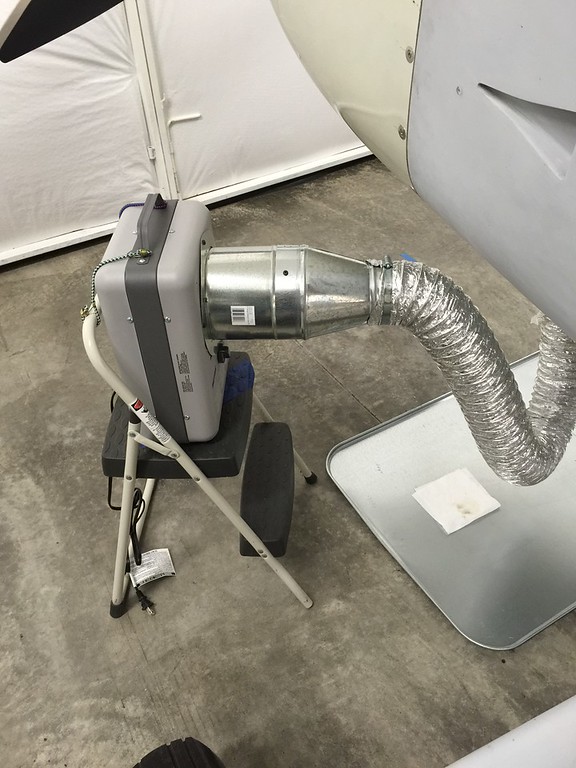

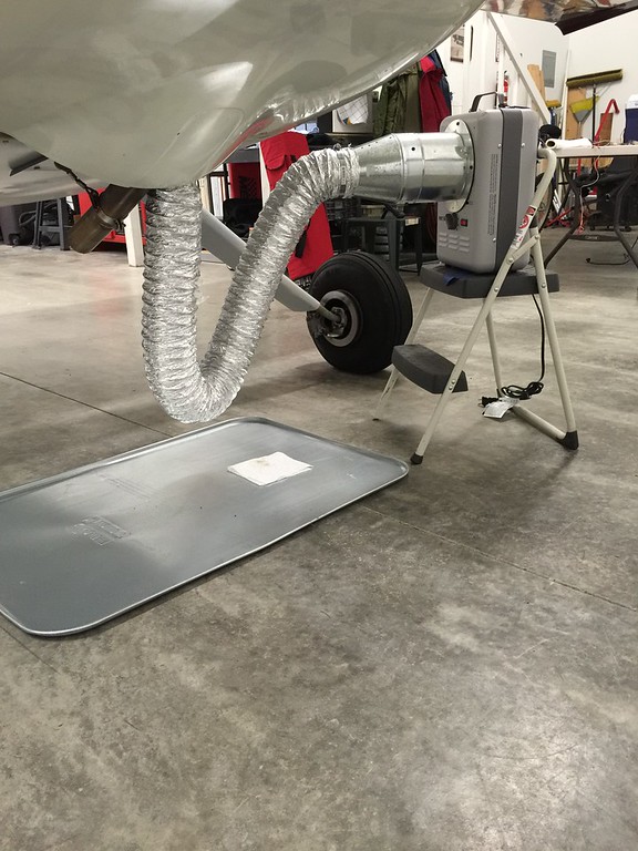

I'm developing a product to solve this!
I had the same problem. I'm tied down on a ramp and the airport doesn't have a heater, so I built one. My basic requirements were:
  • Small enough to be transported in a car and/or plane
  • Had to run completely independent of power
  • Had to be light enough to be carried in the plane without major weight concerns
  • Had to be stable enough to be safe for transport
Below are some pics of my prototype. Forgive the Mooney it's heating. I'm still building my RV. :) I've shown it to a few people and everyone who has seen it seems to be impressed, so I'm working on it in my free time to make it a sellable product. It works well for me. I live in SC so it doesn't get too cold. It's crude and needs some further development for it to be viable in the open market. I'm working on developing it further and giving it more functionality/usability. Some of the current specs:
  • Oulet air temp is around 200F (measured at 55F ambient)
  • Size is approximately 12x12x22
  • Weight is approximately 24lbs
  • Provides about an hour of heat on a full tank/charge
  • Approximately 17,000btu

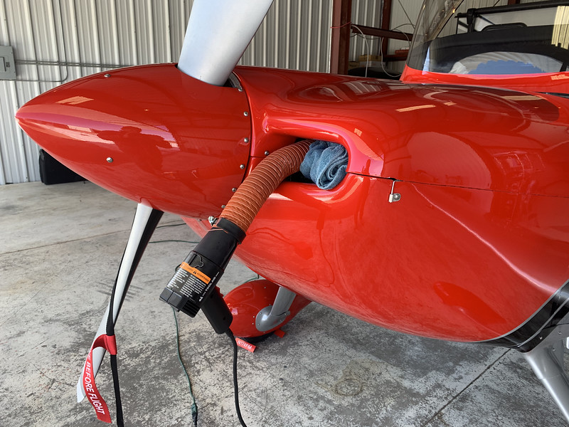

My Solution
$19.99 Walmart heater, floor HVAC register cut to splay out front
foil HVAC tape, dryer exhaust hose. Cheap timer set to come on two hours before departure. I push it over left exhaust, and plug the cowl. Works in my hangar, in Georgia.
