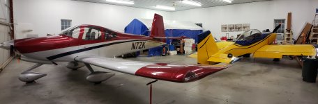

I did it myself and would do it again. Took months and about $1500 in 2015 dollars. Had help from a cousin that had painted cars before. Was aiming for a 100 yard job, but got a 10 yard result. Wouldn't win any prizes, but it is "all mine". It I had to pay $10k+ for just the paint couldn't afford to be in aviation at all.
I painted all of my first three builds. I used PPG primer, base and clear coats. I decided to farm out the current (and final) build (RV-10).
Over a year ago I priced out just the material for this build. It came to over $8K. I did take the time to do all the fiberglass body work and primed (again with PPG primer). As this stuff is the major driver for paint shop cost I’m hopeful that my prep enables me to negotiate a discount.
Here are builds #2 and #3. The paint booth is in back.

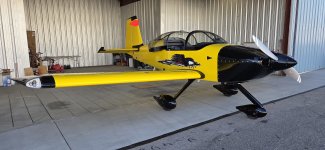

First thing that caught my eye... SILVER. Any metalflake will be harder to shoot. Even with my experience (2 cars way back when, and the airplane) I would not tackle it.
Another lesson learned... it is amazing how different brands shoot differently. My Yellow is PPG Acryglo. Went nice, certainly expensive. The white is Southern Polyurethane's ... much less money. But didn't spray the same. I finally figured out what it needs when I was nearly done. Since it sounds like you are looking to do a 'scheme' my 0.02 would be to stay in a single brand of top coat.
The whole plane got Southern Poly's epoxy primer and I'll always recommend it. Very happy with it.
