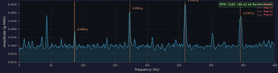

The spectrum display is working, but I still need better underlying data - I'm working on it......

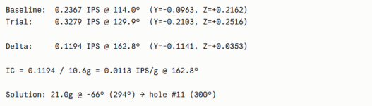

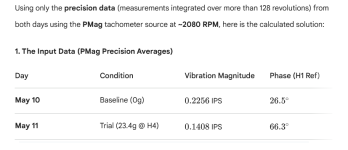

If anyone is still following along - I did an in flight baseline/trial weight balance today. I coded an autocapture to grab the best data from each flight, but still captured all data in the background. Here are the results I got:

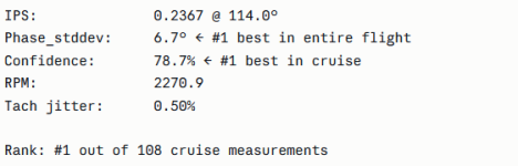

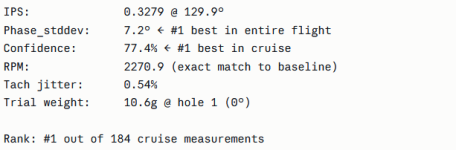

2 best data points for rpm stability and phase std dev
Here is the raw data for the 2 best points:
Baseline
Trial Weight

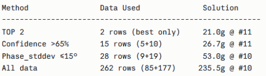

I also looked at using more of the rest of the data including other high quality data points by confidence or std dev, and then just using all data points and got these results:
Direction looks solid - weight has some variation!
I've added 21.36g at hole 11 - hope to fly the solution tomorrow. If it works, the math says I'll show a predicted residual: ~0.047 IPS. I'm skeptical.
Let me know if any of this looks wrong or if I could use other methods. I got the lowest tach jitter in the 4 state area and can hold RPM to the tenth - so there is that! he RPM is an average over 128 revs - thus the decimal///////

I did some timing cleanup in my code tonight using hardware trigger vs software triggers - it should match the engine position to the vibe more accurately. Test tomorrow........ (I say that a lot)

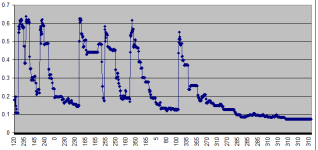

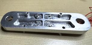

Made it back to the hangar for another test run. My main goal was to improve the tach signal. As I mentioned previously, I suspected the reflections off the prop nuts and washers were causing false tach signals. This is the RPM graph from my last run with two washers spacing the sensor out and the LED PWM still at 30%. The actual prop RPM is right around 1000. All those noisy peaks indicating higher RPMs are likely false reflections.
The solution I wanted to test was a redesigned aperture for the IR sensor. Here's a before and after cutaway view of the sensor mounted on my drill powered bench test. The ideal solution would be a lens to help focus this. But through careful design of the opening, I think we can get this close enough.
Screenshot 2026-04-22 at 10.13.16 PM.pngScreenshot 2026-04-22 at 10.13.36 PM.png
And here is the resulting RPM graph. Still at 30% PWM and no washer spacers.
Significant improvement. The lower RPMs are nice and clean. It's only at full throttle where I get a total of 5 false tach signals. I'm not sure why false signals seem to get worse at higher RPMs. But, I think if I tilt the LED and the receiver openings slightly I should be able to get rid of those too. If not, I'll adjust the LED PWM back down.
The good news is it appears to have excellent sunlight rejection. I was operating without the engine cowling and had sunlight directly on the spinner backplate. I tried multiple orientations and even moved into a shaded area without noticing any difference in performance.
Again my solution would be to move the opening as close as possible (fractions of an inch) to the back of the spinner.

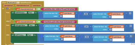

I like the idea of using my Android phone for control/display via BLE rather than running wires to cockpit, but Dang! that's a long road with a steep learning curve! Also, even though I found a dual-core example, I still have to figure out how to share variables between core1 and core2 code, as well as limiting BLE code to just one core.
Looked at video on designing an Android phone BLE app using MIT App Inventor. A lot of work, using that graphic interface. (Actually both there and in the Arduino code.) Each characteristic (piece of data to be transmitted) requires a UUID be defined and much more. But why keep it somple to transmit data when we can make it complicated? ;)
View attachment 115806View attachment 115807
It looks to me that the aperture allows seeing things beyond (above) the perimeter of the spinner. Maybe it is seeing the prop blades or other things?

Here's how I currently have my characteristics set up.
My bad. Should have looked at all the blocks in the BLE project I'd copied. Had only registered for the first characteristic.
Simplified by registering for a different data type for each characteristic.and works now!

I did another test run yesterday. Since the last time, I have redesigned the housing for the LED emitter and receiver. The housing is now longer and the path for both the LED and receiver are angled horizontally. At first it was too selective and I was missing some tach pulses. However, after a few seconds with the Dremel it was working perfectly.
Screenshot 2026-05-06 at 9.44.22 PM.pngScreenshot 2026-05-06 at 10.25.52 PM.png
My previous tests also had a significant problem with clipping. I was using the ADXL345 (a +/- 16 g sensor), and in some of my testing nearly 5% of my samples were maxed out. To help address this problem I switched accelerometers to the ADXL355 (+/- 8 g), but more importantly changed how it was mounted.
With the improved Z axis performance of the 355 I decided I no longer needed the aluminum angle and could just mount the accelerometer directly on a flat aluminum bar. However the ADXL355 eval board I've got has several SMT components on the bottom side. So I needed to mill out some aluminum under the sensor. While I was at it, I cleared out enough room to run the wires under the PCB too. Although not shown in the below picture, some electronics safe RTV was added to the wires to prevent chafing the insulation and help isolate wire vibration.

Looking at the spectrum in post #181 above, it obviously requires quite a dynamic range to isolate the prop vibration, at least for us with gear boxes.

Got my first really repeatable results tonight. Low speed cruise config 2080 rpm. Tach signal from the EDIS ignition. I think I finally cracked the code on filtering out noise in the tach signal.
Here is the polar plot - this is with no weight on the flywheel.
Blue dots are the running 128rev captures that happen in the background and get logged, the 4 red stars each are three, 512rev captures vector averaged as part of the precision balance routine page(Influence Coefficient)
Vector Average Results:​
  • Overall Average (All points): 0.2232IPS @ 318.5
  • Precision 1-4 Average: 0.1801IPS @ 336.1
If the wx cooperates tomorrow, I'll put 15g at about 45 deg to see how the system reacts and calculate a solution

I am about to balance a RV-12iS and using a borrowed ACES 1015 Sport. Reading the instructions, pretty cool. Tells you what to do. Where to put weight.
If you can not put weight exactly at clock or weight specified, you tell it what you can do. It will suggest an alternative second weight.
The kit I am using comes with Lyc and TCM brackets. Being RV-12iSt making my own brackets from heavy alum extrusion angles (scrap from my other RV-projects).
The side open treaded holes in gear box for accelerometer. On back of gear box two threaded through holes above the Pitot tube block, for the optical tach pickup. Manuals says needs to be 12" from target. I should be able to out the target on spinner backing plate.
I intend to leave upper cowl off. The spinner will be on. However once final weight is determined I will have to remove spinner to drill the spinner backing plate, install bolt, nut washers. I will for experiment re-run with final weights on spinner off. If good put spinner back on do final run.
The Temp Weights will be washers in the screws that hold spinner on the backing plate. When I get final Clock and Weight for balance mass (using wsahers), I will have to change to radius and increase weight by radius at on spinner backing plate where final weight is located, divided by radius of washers on spinner screw location. The ACES does not do this I think but it might, simple math no worries, math science physics.
RV-12iS has SB for radiator cracks. My friends RV-12iS is good, not cracks, no cowl interference, good shock absorbing play of mount. However prop balance is a must to prevent radiator cracking. The pay back in time and expense to Dynamic Prop Bal, well worth it, lower wear & tear, fatigue cracks, rubbing.

Did a ground run this morning.
Algorithm won't work to this degree:
Even though I limit samples used to less than 0.25 Gs you still get this phenomena: a "high" G sample (wind gust, combustion event, prop interaction with ground or whatever) can cause a slot to have a max value compared to other slots (even if event might be added to other slots too) and it takes a while to average that down:
(Y: ips, X: angle degrees) @1,050 prop RPM
This is even with the "DC" (offset errors) component dynamically removed.
Note that I did clear the sample buffer a few times during the 20 min run. Need to improve the phone app to also log target RPM and buffer resets.
In this case it appeared that it settled down to 0.075 ips at 310 degrees. So I actually need to look for the angle of the lowest ips value it averages down to, it seems.
I guess I should try to add a test weight next.

So how do we know what the critical speed and natural frequency of our engine/prop/gearbox systems are?
Well - I have a solution. Not sure if it works - that will require another flight, but here is what I have.
Yesterday I got baseline data with no weights installed, today I added 23.4g at hole 4 and flew again. Theses are the resultant solutions:
I'll add these weights and see what I get. The ACES solution 2 years ago was 19.7 g at hole 6@2270 rpm. So I'm in the right universe.
I let Gemini do the math here - and cross-checked it with Claude -they argued a bit, but they finally agreed. This is a low speed- cruise balance. Later, I'll try one at my high speed 2270 rpm cruise as well.
