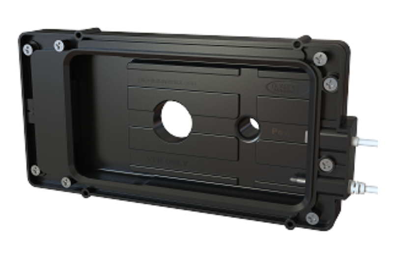

We considered pretty much every possible path here. The iFly 740 won out by a good margin.
Hoping to get time to solder up the cable tomorrow, so we can flight test this weekend. Really looking forward to seeing how well it all works together.
DaleB,
Once you get the 740 mount dialed in, are you going to consider making a kit for sale? I would certainly be interested. I basically ignore my 396, except for the autopilot input, and rely on the 740.
DaleB,
The mount I cooked up is unique to the RV-12. I'll certainly publish the Solidworks file and the STL so people can 3D print their own. It's a pretty long print job, so I'm not sure about offering to print for other people but I'm not ruling it out. I could make it a lot faster by printing it in two pieces to be glued together. As it is, the "clip" part at the bottom means nearly the entire thing gets printed with supports, which takes an extra hour or so.
I wanted to make sure it was stout enough to withstand normal use in a -12, including getting bounced around in turbulence. I lack the engineering chops to conduct any sort of stress analysis, but at present I suspect it's somewhat over-built. I'm fine with that, but I would like to slim it down a little if I can. I made the main body of the mount .25" thick, with counterbored holes for the screw heads. In hindsight, I could probably make it a lot thinner and forego the counterbores since the scree heads are nowhere near the GPS itself. I guess I just got a little carried away learning how to do stuff in Solidworks. :)
After we fly with it for a week or two, I may try a Version 2 design to use less print time and plastic, get it a little closer to the panel, and still be strong enough not to worry about it flexing or breaking.

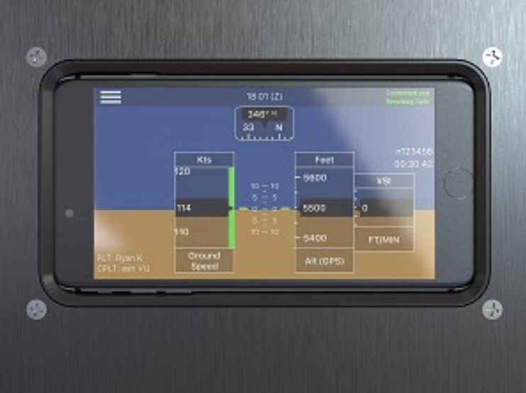

I have had my 740 since it was introduced. Made a simple channel clip mounted to the panel. The 740 slips up under it to secure the top of the unit to the panel. The bottom just pushes to the panel and held with velcro. It sets right on top of my transponder and is flush with it. Can be removed in 15 seconds.
The unit is full of features and is well supported. But it has one flaw...... REFLECTION. Plan for it.

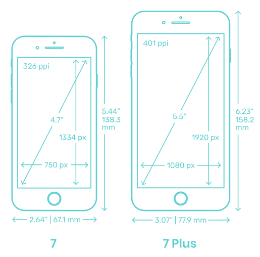

See post #49 above. Today I took the iPhone 7 running ForeFlight out to the plane for a flight. Overall size is nearly same when I held the phone in front of the Garmin 296 and screen size may actually be a little larger. I ran the phone in “Airplane Mode” and connected WiFi to the uAvionix UAT transceiver for traffic and weather. Worked a charm. Display is very readable in bright sunlight, and when positioned in front of the Garmin at the top of the radio stack, glare off the screen isn’t a problem either. Larger screen on iPhone 7 Plus might be ideal...
My conclusion is that the phone would be a good replacement for the Garmin allowing same touch-screen capability as a mini iPad. This idea has some merit and I will give it further consideration.
Pros / Cons…
• I would lose GPS position data sent to the D-180 if I removed the Garmin. In my case, not a big problem because I don’t have autopilot. Essentially, I would lose winds-aloft display on the D-180.
• How to power the phone with ugly plug-in connector – maybe run on internal battery and charge after each flight? Maybe wireless inductive charging from back of phone?
• Mount to panel using a cell phone case. Cell phone case would be similar to and function like a Garmin AirGizmo dock. Installation would be really clean.
• iPhone 7 Plus has larger screen and can be bought used for less than $200

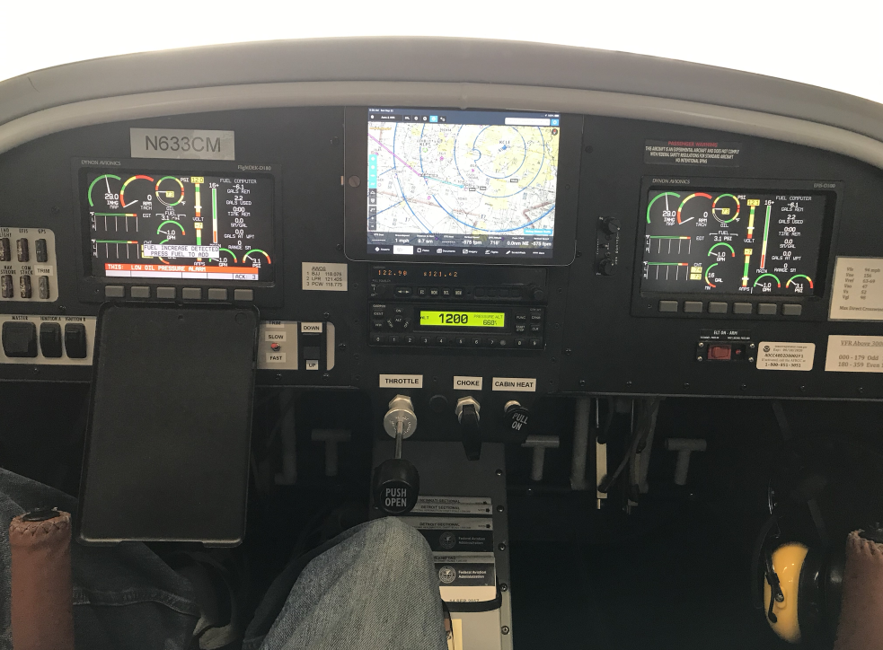

Well, its finished for now. I installed everything yesterday, but the D180 wasn't getting GPS data. Found some wires swapped, fixed that, but still no joy. This morning I replaced the ancient USB to serial adapter I had (bought years ago and used for all manner of lab and bench experiments) with a new one from Best Buy. That worked. I took a 45-minute test flight, got ADS-B traffic on the display, played with the flight plan, tested the AP and CDI, everything works as it should. We'll need to spend some time setting up the screen to show what we want, but that's pretty simple to do. I requested a PAPR report post-flight, because I've been making adjustments to the echoUAT threshold settings. Even that was near perfect -- 0.26% BARO ALT failures, so nothing bad.
Overall I'm happy with it. It doesn't block the radio display like I was afraid it might. I'll probably print one more mount with a few tweaks to make it more stable when using the touch screen.
Reflection from the screen is a little much to get good pictures, but not enough to make it difficult to read. A non-glare screen would have been a plus, but it's pretty low on the list of things to gripe about. It's more legible then the D180, really. I like the alerts for traffic, airspace, etc. Now the only thing left to do is figure out which AV board volume control to tweak to get the audio louder -- I can barely hear it with the iFly volume up full. Too bad you can't get at those without pulling the forward skin, that's a PITA.
TONS better than the 496, and better than the 496 and a tablet. It's a win, I'm happy with it.

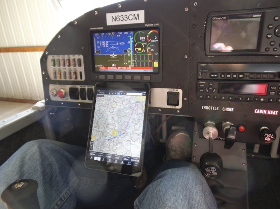

I?ve decided to get serious about replacing my Gamin 296 with an Apple device so I can run ForeFlight on a second screen. I have a Mini iPad mounted at an angle below the pilot?s D-180 and I like this mounting position.
ForeFlight allows multiple devices to be used at same time on a single account. Now I want to replace the 296 with an iPhone 6S+ that has a 5.5? display. ForeFlight has cockpit sharing and synch to make one display a master and the second display a slave. This will make programming routes for both displays very simple.
I can buy a refurbished iPhone 6S+ for $150 and a Guardian Avionics SmartPanel mount for $129.
Stay tuned?

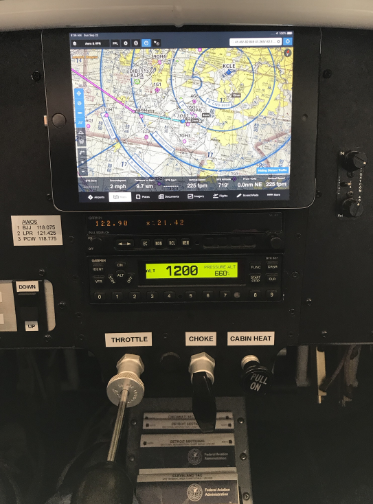

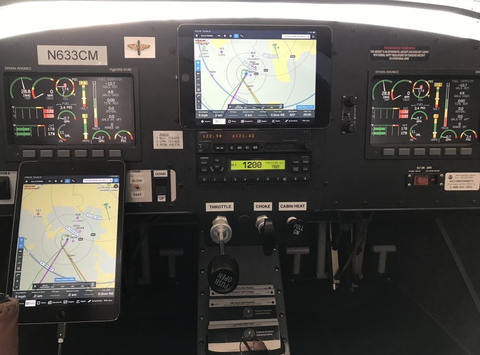

So, I went out to the plane this morning to see how an iPhone 6S Plus might fit to replace the Garmin 296. By chance, held the mini iPad up over the panel hole and it fits perfectly. On my airplane there is enough clearance between the canopy bow and the panel for the thin iPad. So, there’s my answer – I’m going to run two mini iPad’s on ForeFlight with cockpit sharing between the two displays. I'll probably run the center screen on Sectional map page and the angled screen on Aeronautical map page which is better for viewing traffic and weather.

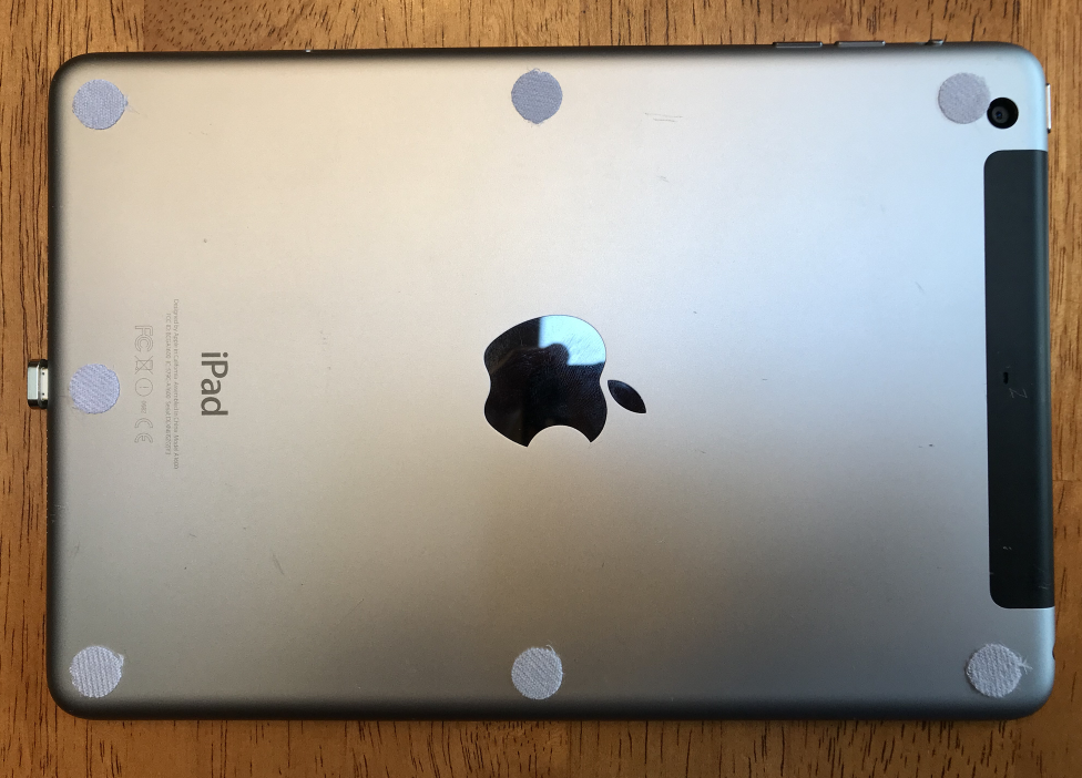

The new mini iPad will be “fastened” to the panel with Velcro 3/8” discs so unit can be removed for updates. The top four panel screws need to be changed from round head to flat head so unit sits flush.
I’ll decide later if a power cable is desired. The mini iPad has an internal battery that operates for ten hours so I may just run it on its own power.
This will be cool….
host image
I?ll decide later if a power cable is desired. The mini iPad has an internal battery that operates for ten hours so I may just run it on its own power.
Before deciding, I?d suggest running your iPad on battery power as close to in the exact configuration as you will be running it in the airplane, and seeing how the battery does. The amount of time that you get on the battery will vary significantly depending on how you have it setup.. screen brightness, WiFi on/off, Bluetooth on/off, the apps you?re running, what you are doing with those apps, etc.
I would not be shocked to hear that your ?ten hour iPad? battery lasts for 2-3 hours the way that you?re using it.

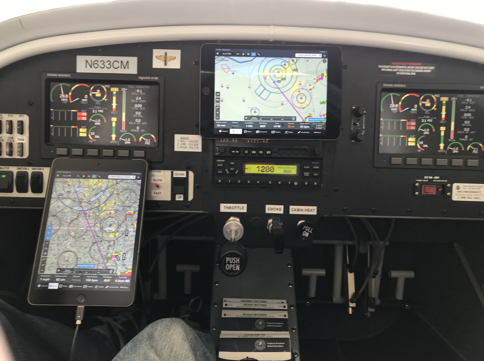

I flew with both mini iPads this morning. Totally cool. 4-leg route was set up on my iPhone at home running FF and then, when I got to the plane, I did cockpit sharing and transferred the route into both mini iPads. In the air I could pan ahead and zoom to see close traffic on one screen while the other remained optimized for cruise flight.
The new center screen (mini 4) used 25% battery for the one-hour flight - not bad. I?ll continue operating on internal battery for the interim.

Final installation...
How about some pictures Jim?
That is the picture...
Remove instrument bay cover sheetmetal to gain access to screws holding old Garmin mount. I left the GPS antenna cable and Garmin power cable tucked away behind the panel. Install four flat-head screws at top of instrument panel so iPad can mount flush over large hole vacated by the Garmin. I mount the iPad with four small pieces of 3M Body Side Molding Tape - one on each back corner of the iPad. iPad can be removed with razor blade to slit the mounting tape. Perfect...

Well, the bad news is... my 3D printed mount failed. I'm really not THAT surprised, since the little mounting bosses have shear and tension stresses on them in the exact wrong direction for the 3D printed layers. In other words... the weakest part is the part that's stressed the most, in its weakest direction. Oh, well... it was a fun exercise designing and printing it, at least. If it were injection molded in ABS, it would probably last forever. And, my CNC router doesn't have enough axes to do the job.
Not a big problem. I'll fabricate a simple aluminum plate, with a hole for the cables, to cover the hole from the 496. I'd much rather just replace the center portion of the panel, but that would mean pulling the throttle, choke and heat cables... no thanks. Anyway, we'll either mount the iFly GPS with some industrial Velcro, or use a commercially available injection molded part attached to that.
