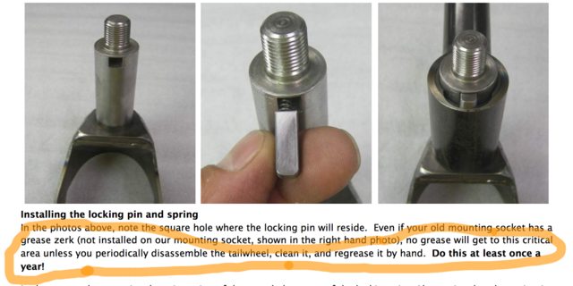

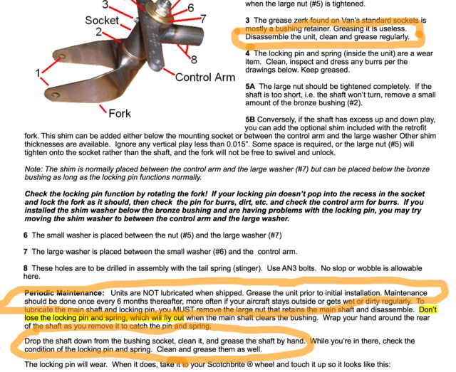

Grease here is not the problem. Just about any grease will work. A moly waterproof grease is probably best. Takeaway is that the thing needs to be disassembled.
The pawl is subject to wear and needs to be replaced often. It is cheap, around $7. When the pawl gets worn the tail wheel will kick out and you will lose steering at the most inopportune time. Don't ask how I know this.
+1. None of the popular tailwheels have a seal at the top of the shaft, so they all collect dirt and grit in the area of the "tombstone" pin. Regular cleaning is the hot ticket.

The pawl is certainly easy to replace. However, the original pawl is still in my 1999 RV-6. The key to good service is to make sure no burrs have formed on the pawl. A light filing of the long edges of the pawl to prevent it sticking in the bore, cleaning and grease will keep the pawl functioning properly for a very long time.
Lock Pin
I second this. I've replaced my pin once in 900 hours and mostly because I was worried about it eventually breaking from fatigue which happened to a Harmon Rocket guy I knew. I disassemble, clean, and re-lube my tail wheel assembly 1-2 times per year. After I disassemble the fork from the gooseneck, I clean everything with coleman fuel. I then check the pin for burrs and usually kiss the edges of it on a scotch-brite wheel. I also check to make sure no burrs have formed around the edges of the broached pin-bore in the fork and file as needed. Finally I grease the fork assembly BELOW the locking pin bore and use LPS-1 on the pin, spring and steeering arm when I reassemble it. I try to keep grease away from the pin and use dry-lube here because grease in this area can trap grit and cause to pin to stick in the disengaged position.
Issues with the locking pin disengaging too easily are most likely due to rounding of the corners of the "notch" in the steering arm.
One other note: When I built my -8, I found that the washer that sits on top of the steering arm was resting on the root radius of the threaded portion of the fork assembly which resulted in a lot of end-play of the arm. I cut a chamfer on the ID of the washer which allows it to sit down flat against the step on the steering for shaft.
