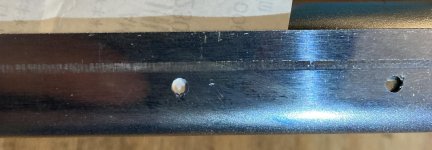

Is this only an issue with the final size kits?
I’m building an -8 which we have to drill to final size, and it has some laser cut parts in the fuselage. I can’t see any holes with notches in that need filing out, and certainly not when drilled to final size.
I am building a 9 and just got my wing kit. The flap spar is laser cut and some of the holes definitely have the indentations, particularly the #40 holes. They are big enough to catch the tip of my fine sharpie.
I have not yet match drilled so I don’t know if it will go away.
Manufacture date is 7/18/22.
Last night I also dug out the cutoffs for rudder and elevator stiffeners. Those were laser cut as well but the holes look round. These parts were delivered in May 2022 so must have been produced before that.

Keep the reports coming Boys and Girls. This issue needs immediate addressing and no better way than to keep the issue front and center until resolved. I am really irritated at the lack of QC going on over at Vans. How in the world did all these flawed parts get sent out the door?
What are the odds some of the subassemblies we’ve already constructed will need to stripped for critical parts replacement? I’m not sure I would have it in me to take on such a task.

Report on my -14 build. Tail kit received 12/22.
Tail feathers are done and stowed. Have not looked at the stringers yet.
Tailcone stringers had small bumps in laser cut holes (not as bad as some pics).
A few strokes with a round needle file would smooth it out.
Dimpled stringers and riveted to bottom skin. No cracks observed thru light primer. Holding off on side stringers and skins for now.
