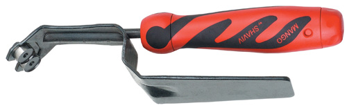

I got a tool kit from Cleaveland tools which included a speed debur (buy an extra bit so you have a separate bit for fibeglass) and a debur handle and kit from Shaviv. I think ACS also carries that handle and bits.

Thanks. I have a bunch of scotchbright pads and a few deburring tools for drilled holes etc. How about scotchbrite wheels for skin edges, lightning holes and edges of parts? What works well on die grinder dremmel or bench grinder?
I have used the 3m 1" wheels from Cleaveland https://www.cleavelandtool.com/shop/category/deburring-44 on a milwaukee cordless die grinder quite a bit as well as the 3m light deburring wheel on a harbor freight buffer. The other thing that works well is some fairly fine grit sandpaper by hand or using a small dowel or piece of wood to back it and get in tighter areas.
