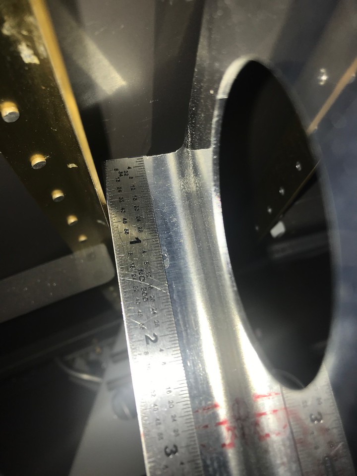

Just curious. Have you tried installing the extra tall panel? I couldn't find an easy way to slide it in place and finally gave up and went back to the standard. I want to be able to pull the panel as a unit to work back there.
I saw your log actually. It was kind of puzzling because the full size/width panel looks like it should fit! Was the canopy deck the way? Even given the trouble you pointed out, I was going to still give the full-width single piece panel a try.
Just to follow up on this observation. Yes, upon getting the full-size panel, there is indeed a clearance issue with installing it! It's not the extra-tallness that's the problem, it's the width: I had a panel cut that stretches end-to end in one piece (as opposed to the removable "ears" for the vents) and found that it is impossible to install due to needing to pass the F-704H center section uprights:
It's about 1/2" too wide to install. My plan is to carefully cut 1/4" off of both extreme outboard ends, and it should pass through. Let this be a lesson to future panel designers. There is a reason Vans made those vent pieces removable!

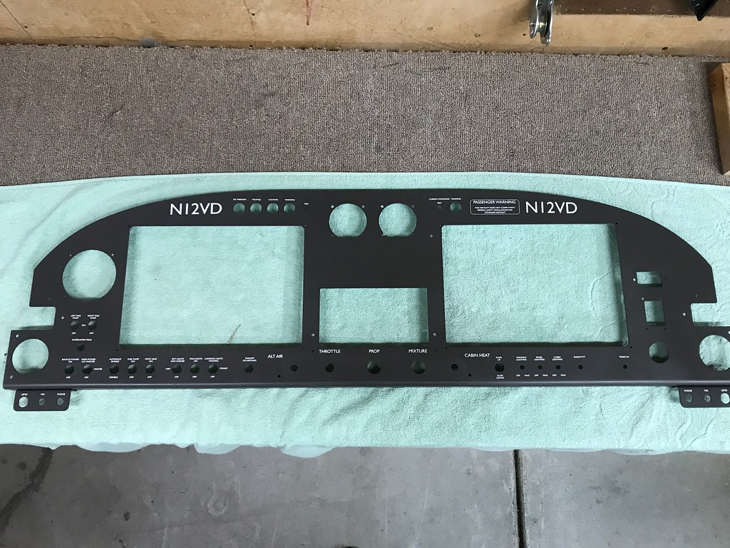

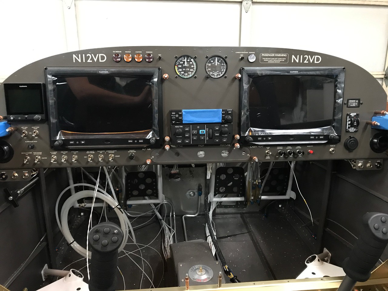

Well, this panel design has become reality. Thank you all for the feedback and guidance. The panel turned out exactly the way I wanted it!
Here's the result:

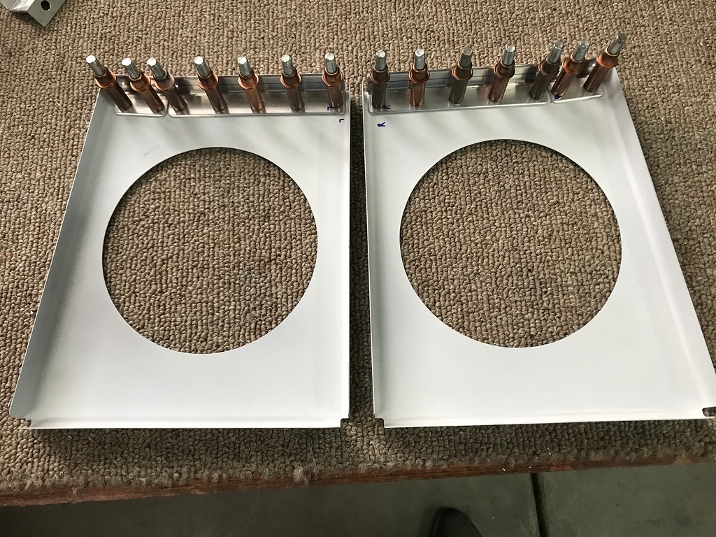

Some prep work. Removed the aft half of the subpanel ribs and relocated them inboard to fit the 10" displays:

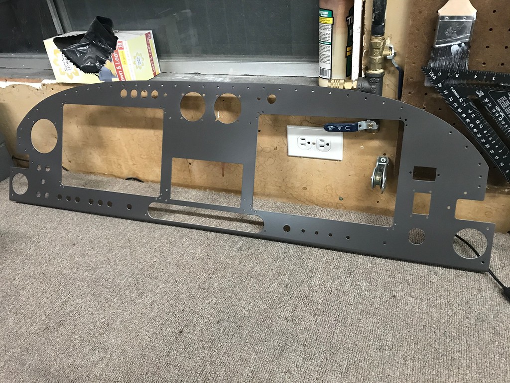

The panel was cut by Bill at Up North Aviation. He did a super and precise job AND offered a few design tips that simplified the oval section that houses the engine control cables. The paint is the same rattle-can Rustoleum I'm using for the rest of the interior.

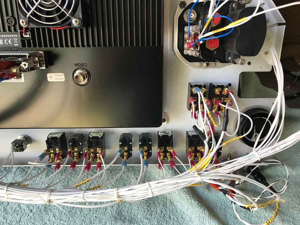

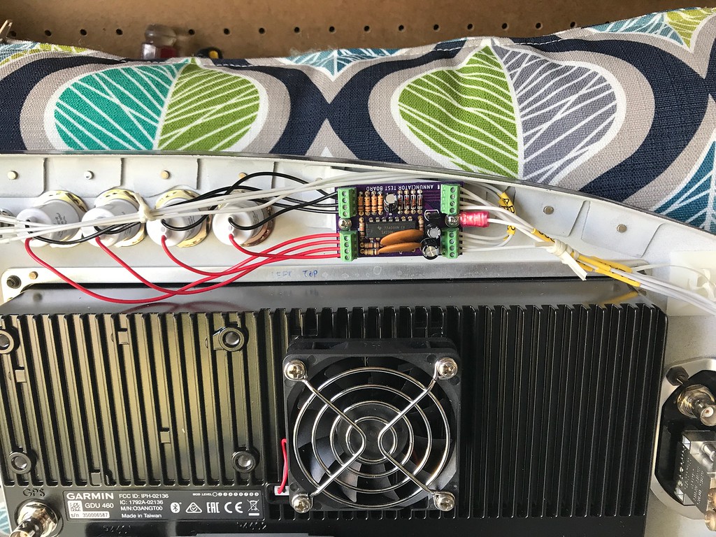

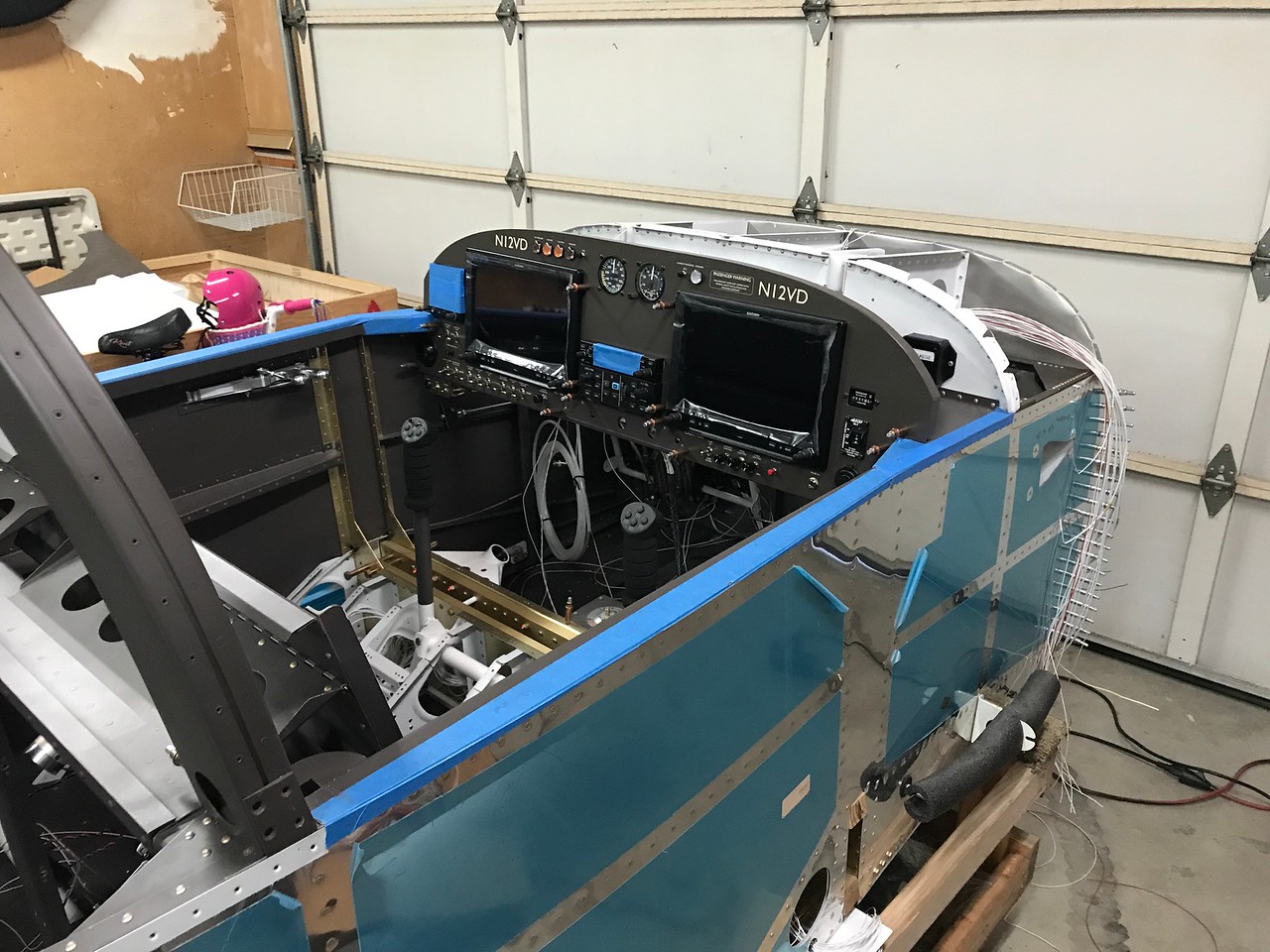

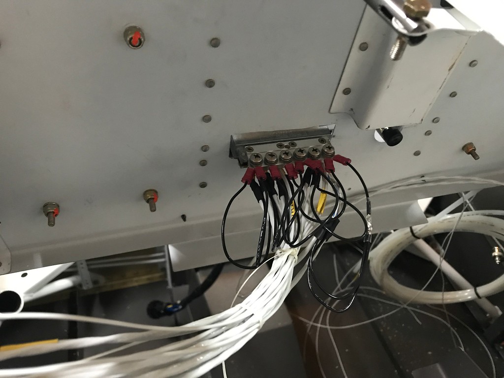

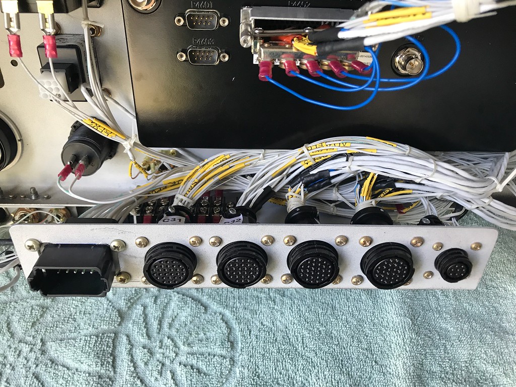

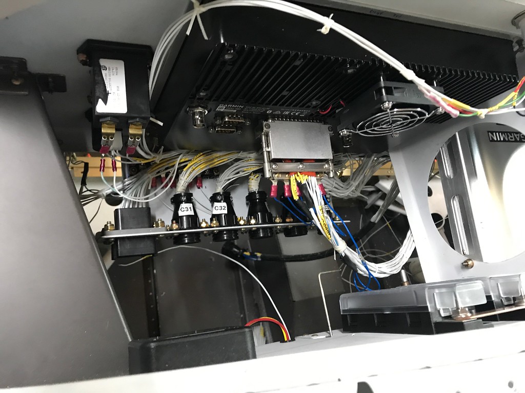

After what seemed like centuries of wiring, it's done:
Everything fits! Glad I did the design in 3D, with the forward fuselage model Vans provides. Allowed me to make all my mistakes on the computer rather than on the airplane:
Garmin's COM radio is just a bit too long, and extends through the subpanel, so you have to cut two holes for the connectors to pass through:
Overall super-happy with the way it turned out. Very motivational milestone!
