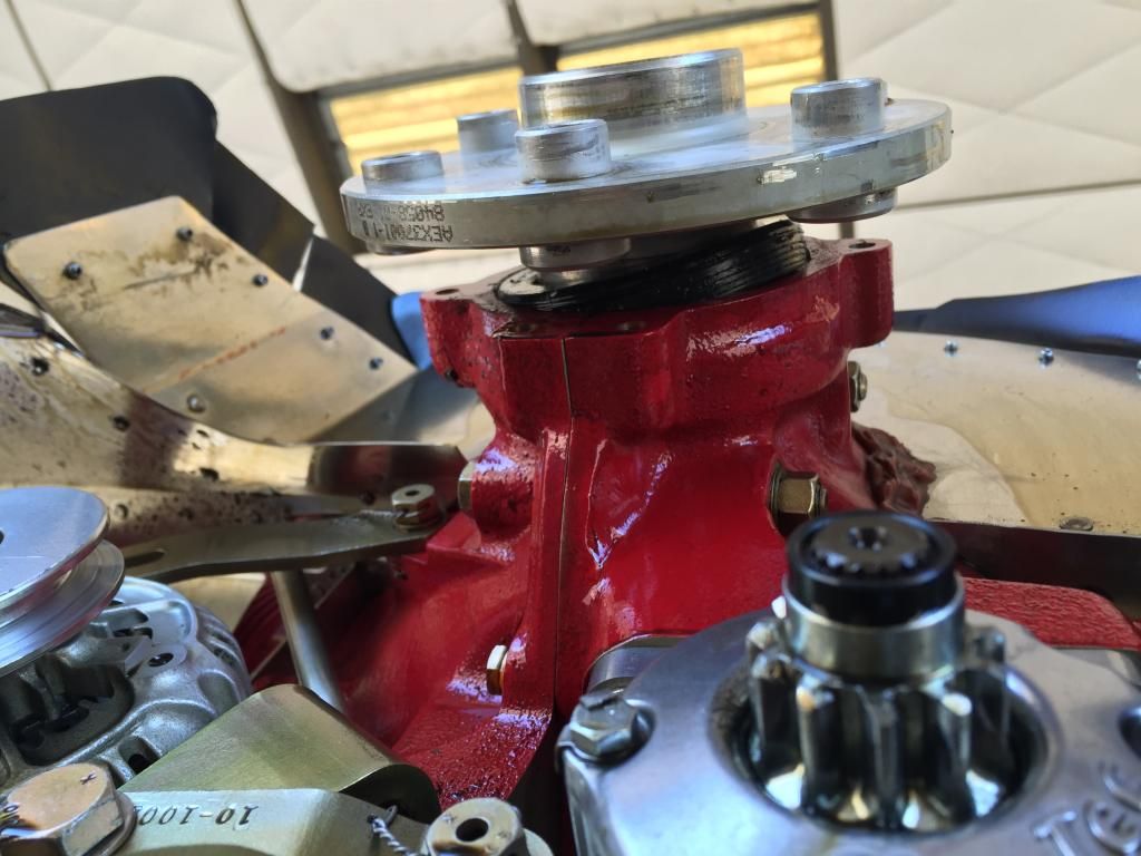

Last Thursday while flying from Goodyear, Arizona to Boulder City, Nevada the crankshaft seal on my IO-375 blew out. The windscreen on my RV-8 became completely covered in oil in about 10 seconds and I was unable to see anything out the front. Oil pressure remained in the green, but at the rate oil was coming out the front of the airplane, I knew it wouldn't last long.

A download of my Skyview flight data shows that from the first indication of a problem until touchdown at Kingman was 5 minutes 30 seconds. A post flight check of the oil quantity showed 3 quarts remaining. I started the flight with 6 quarts. So I was leaking oil at about a half a quart a minute. If the crankshaft seal had blown out somewhere else over the Arizona desert where airports are few and far between, there is no way I would have made it to a runway, so I was quite lucky.
The next day, Air?Zona Aircraft Services at Kingman repaired the blown crankshaft seal and helped to troubleshoot the cause. I have an Anti Splat Aero oil separator that uses a crankcase vacuum valve attached to an exhaust pipe. I am very happy with the oil separator and it has always worked exactly as advertised. The inside of the fitting that connects the valve to the exhaust had heavy carbon deposits and was restricted to about 1/8? diameter, certainly enough to cause crankcase over pressure. The fitting has been installed for 24 months and has never been internally inspected. There were no other blockages in the oil separator or hoses to and from the engine. I will now clean out the valve fitting at each oil change. I believe there has been some discussion on this potential problem here.
The risk of crankshaft seal failure caused by carbon buildup inside the vacuum valve fitting should be reemphasized. That?s really the big lesson learned from this episode. I always run lean of peak and my EGTs are typically around 1200 F. I would be interested to know if there is a correlation between exhaust temperature and a tendency for carbon deposits to form inside a valve-to-pipe fitting.
