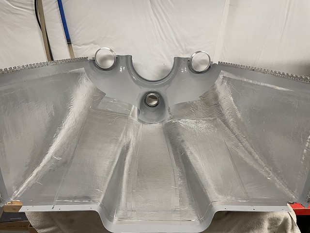

I see lots of threads on cowl heat protection but the links are all broken. My cowlnis sealed with epoxy then painted with 2K epoxy primer. I still want to protect the hot zones.
The consensus seems to be 1/8" fiberfrax mirroring the exhaust pipes with some sort of self adhesive aluminum foil.
Is 1/8" the thickness? How wide?
https://www.aircraftspruce.com/catalog/appages/fiberfrax.php
Is this the aluminum foil stuff?
https://store.vansaircraft.com/ea-exhst-cowl-shldx5-ea-exhst-cowl-shldx5.html
1/8", about 4" wide. Yes, that's the foil.
Been on there 12 years. I use it on the variable exit panel too, and it's very close to the header.
I have used 1/16 fiberfrax and the foil with great result. The cowl stays cool to touch after landing.

Put some on order from Vans, while you are waiting, you could cover the hot spots with strips of 2" aluminum self adhesive tape found in your local Home Depot - Heating & ducting section. Go for the solid aluminum tape, not the plastic/aluminum stuff.
