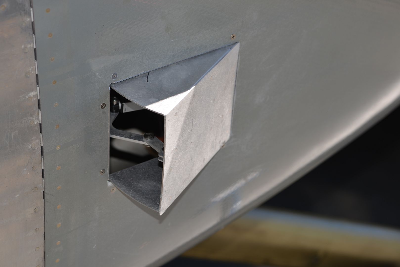

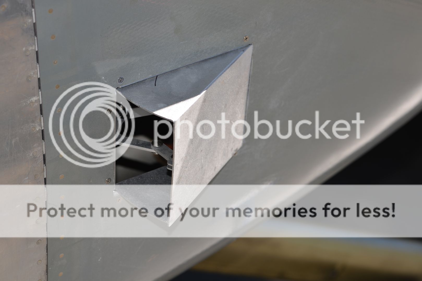

My RV10 is a wonderful airplane, but I have always had to moderate my climb in order to keep the CHT's below 400 deg. (My personal goal, not the Lycoming recommendations.)
No longer is this a problem thanks to Allan Nemo's EZ Cool Cowl Flap system! Now I can climb with a full load from sea level to 5000 ft at 1000 ft./min. on a 98 deg. day and the CHTs never break 380 deg.

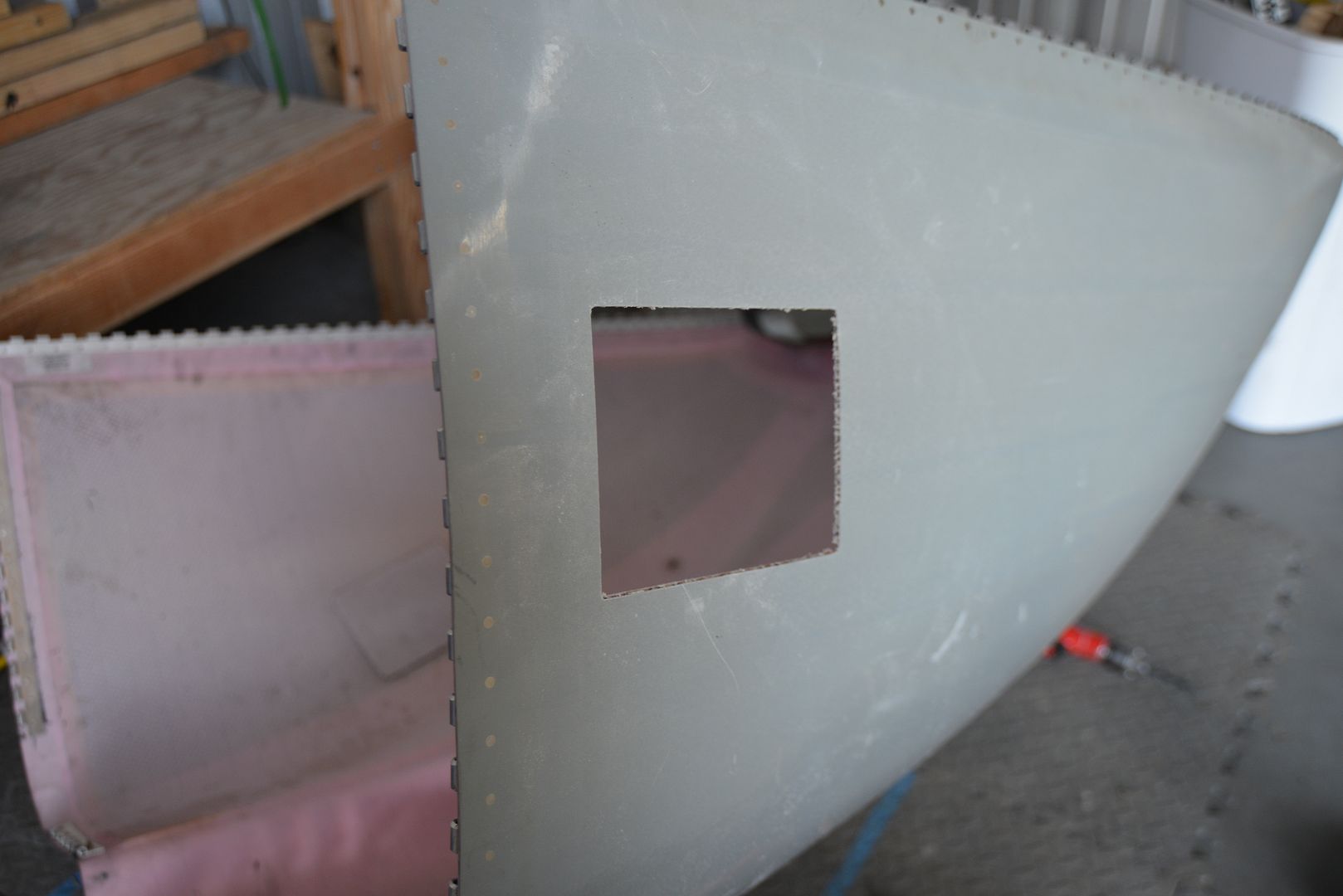

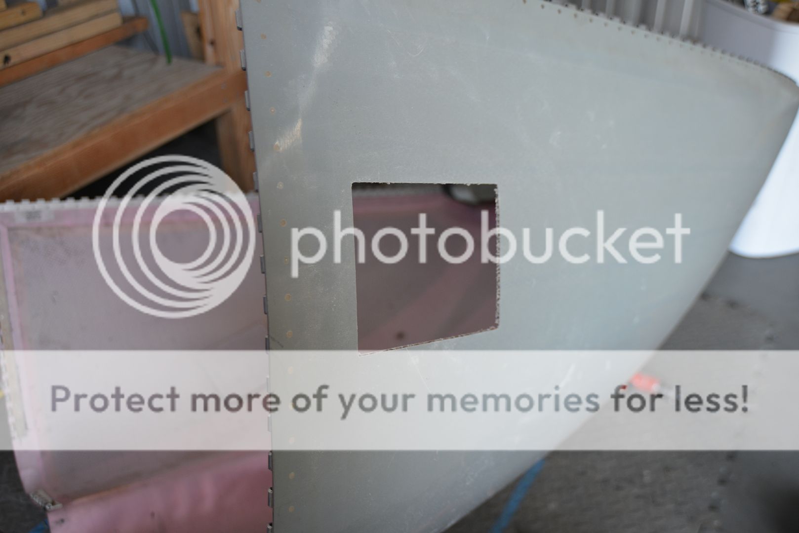

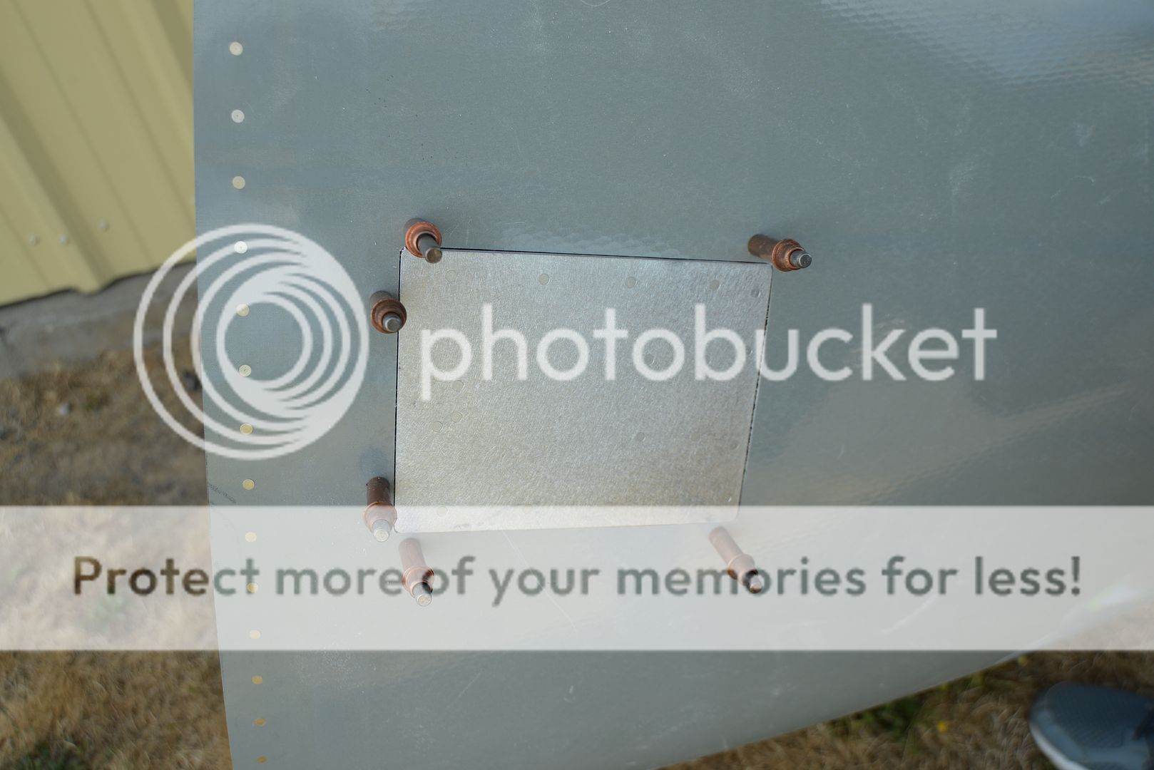

1) Positioning and making the hole in the cowl
I decided to put the flap on the side of the cowl as opposed to the bottom so as to avoid interference with the exhaust stack etc...
The hole was cut with a vibrating "cast saw" tool that could be precisely positioned and controlled. The hole was cut a little small and then enlarged with a file/rasp to the perfect size.
(More to come later)

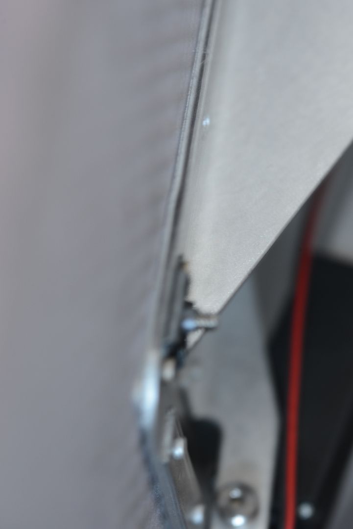

Shimming
When the cowl flap assembly was inserted into the opening the flap stuck out into the breeze a little bit, so a shim of 0.040 aluminum was fashioned to place between the flap frame and the inner wall of the cowl.
You can see the trial pieces that I used in this picture. They are the blue plastic covered bits.

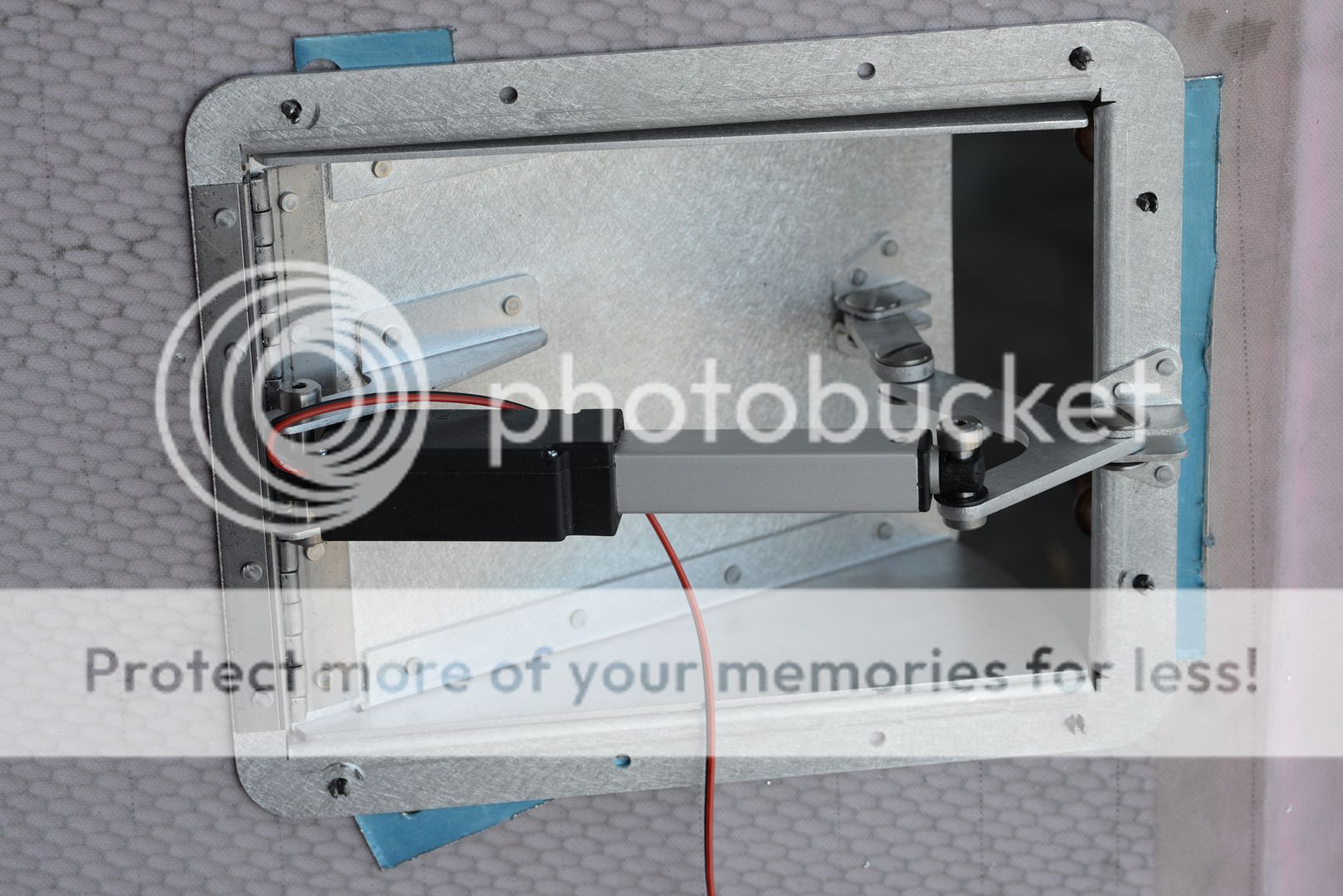

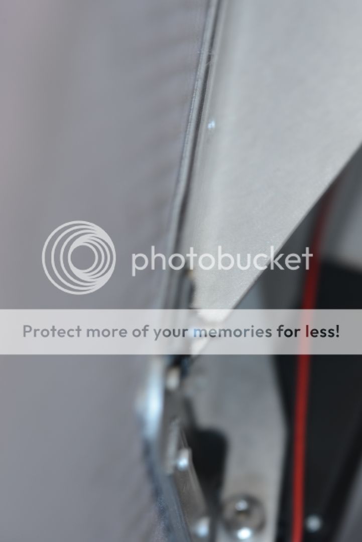

Nut plates
#6 Nut plates were then installed in the cowl flap frame. The nut plates captured the 0.040 shims that had been created.
The opening was sanded to smooth out the injected fiberglass, and the flap was mounted with #6 counter sunk screws.
Forgive the poor picture, but you can see the nut plate here.

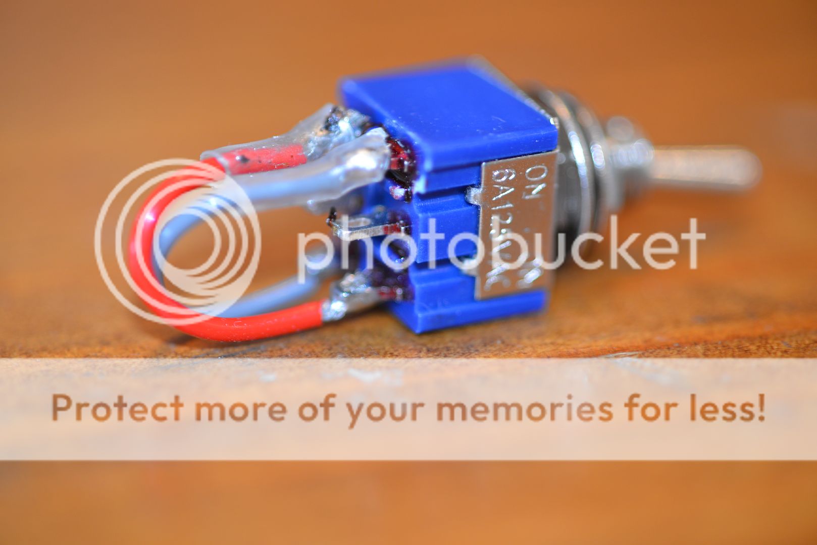

Wiring
It is important to follow the wiring diagram that Allan provides in the kit. I did not pay close attention at first and the flap did not work properly.
Here is a picture of the switch wired.

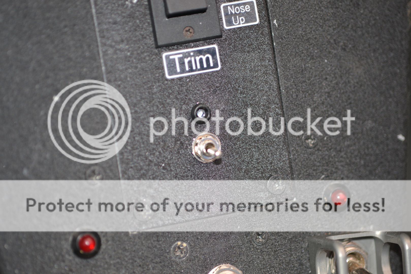

And here is a picture of the switch and it's indicator light installed in the panel. (Ignore the "Trim" label above the light, it belongs to the switch above.)
Highly recommended!
What a joy it is to be able to take off on a hot day with a full load and quickly climb up to cool altitudes without cooking the cylinder heads!!!
The kit is well made and simple and the instructions are adequate.
I would recommend this modification to anyone who has any issue with cylinder head temps.
It is definitely a valuable add-on for some aircraft, it made a huge difference for my 9A for a max-performance long climb in west Texas summer temps.

Your installation story answered one question I had when I received my ASA cowl flap recently. The frame is made to fit into a cowl that is about 1/4" thick. I planned to install mine in the middle of the "coal shovel" exit channel, which is not honeycomb sandwich. It is about 1/16" or less thick. So I was wondering why oh why did Allen make the frame drop in so deep? Whose cowl is so thick? So now I know. In the honeycomb areas, the cowl is apparently about 3/16" thick? so it apparently still took a bit of shim under it, based on your post.
Since I was mounting in much thinner material, rather than have a big layer of build-up on the inside to get the flap flush on the outside, I made a new frame that is just 0.063" thick, and re-assembled the flap on that frame. A spacer was needed under one of the actuation linkage anchor points to keep the actuation geometry working right. It is a fairly clever actuation linkage. With the thin frame, the cowl flap surface was slightly below the cowl surface, so I slathered a layer of epoxy/microballoons over it and then sanded it completely flush. The area where it is installed is not flat, it is convex, so it was going to take some filler to contour in any case.
