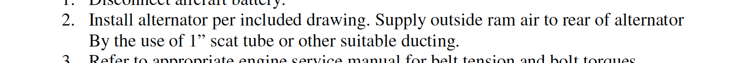

The installation documents for my alternator have exactly zero to say about cooling, but mine was from back when Plane Power was it's own standalone company. And after pulling it apart, I'm not convinced the fan actually does anything. Anyway, it's worked well enough and I'm not looking to change something without cause.

Excerpt from page #2 of the installation docs circa 2005 attached...
Interesting. There is no such note like that on my instructions from 2009. Maybe I have a different model of alternator.
Edit to add: Regardless of alternator model, the main idea from my post still stands - avoid ducting water from the blast tube into the electronics. Electronics and water don't mix well.
I never considered water ingestion for the alternator cooling before. If taking it off the rear of the baffles, it's likely not an issue. If you take the air off inlet ramps, probably a huge issue. I'm waiting for my new tubing to arrive and will likely put a definitive low spot or even a full loop in the tube with a 0.25” drain hole before routing the airflow to the alternator.
I actually called Hartzel about installing cooling and specifically asked about water coming through the vent tube. The tech rep with whom I spoke said cooling was recommended and he was not concerned about water intrusion. He said the only place he would protect from water was the plug and recommended putting RTV around the plug.
