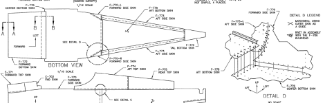

Yeah, I'm not sure the instructions actually say that. The side skins go on top of the bottom skin, ref. DWG 28, upper left shows Bottom View and check Detail D.

Unless I’m missing something or completely interpreting the drawing you referenced wrong, it appears the belly skin overlaps the side skin. That seems consistent with all the build log pictures I’ve looked at as well.

Look at the Bottom View. The dashed lines are the hidden lines depicting the edges of the F778 Aft Bottom Skin, which is "underneath" (as viewed from below) the two F773 Aft Side Skins. Detail D further depicts the stack up, from bottom to top, as F776 Center Bottom Skin on "top" of F770 Forward Side Skin, which is on top of F773 Aft Side Skin, which is on top of F778 Aft Bottom Skin.
I'm not even sure how you'd do that...I'm not at the hangar now, so no access to the plane or pictures on my other computer, but doesn't the bottom skin have a raised stiffener on both sides that runs fore to aft? As shown in Detail D? That's what I recall, at least, from my build (it has been a long time now). But your bottom skin looks completely flat. ???
AHA! I think we're at cross purposes...you called it "belly skin", and I thought you were talking about the aft bottom skin. You're talking about the CENTER botton skin, am I right?
If so, just ignore everything I just said LOL!
Yes, bottom center skin. At the conical bend area where the side skin is sandwiched between the center bottom skin and the corner rib. I think we got it figured out, lol.
