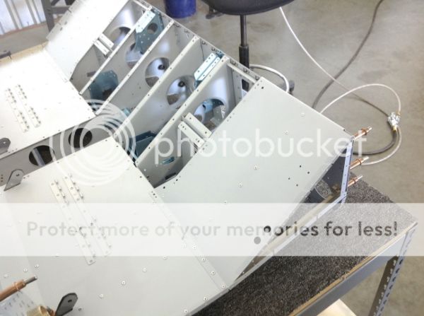

I hope you can make it to the Chino air show this Saturday. I've been asked to display my -12 ELSA project in the RV Fly-In area, same hangar row, about midway. Be glad to answer any questions...that's what it'll be there for. The photo above was taken a while back. Current config is quite farther along.
